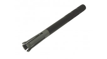

Can anyone suggest a 1" headset removal tool that will fit in a short (4") head tube?
I've got an Icetoolz Xpert 1" - 1 1/8" headset removal tool, which works fine most of the time, but on my Reflex ALX89, it doesn't have enough space to de-compress and engage the cup. The tool is about 30cm long, and the splayed parts take up about a third of the tool. It looks a lot like a Park RT-1, so I'm worried about making the same mistake twice. :?
Why not make your own. An old seatpost with 5 or 6 slits sawn down it for a couple of inches then splayed out. I've made one and it's removed dozens of headsets with no problems at all.
I've only got the 1" one myself (proper retro :D ), but you might try the Cyclus tool (#94100033):
It has a big machined end on it and a slimmer shaft, so it doesn't get squashed shut by the other cup, unlike the ones that are just split tubes.

A proper 1-1 1/8" cup remover is a must if you want to protect your precious headset from damage
Like this :shock: (not mine i hasten to add)
Thanks for the offer of a loan - the Cyclus tool looks perfect for the job! However, I reckon postage both ways is probably about what the bike shop will charge for doing it. Anyway, I prefer having my own tools - if this retro habit keeps up, it'll get a lot of use! :)
