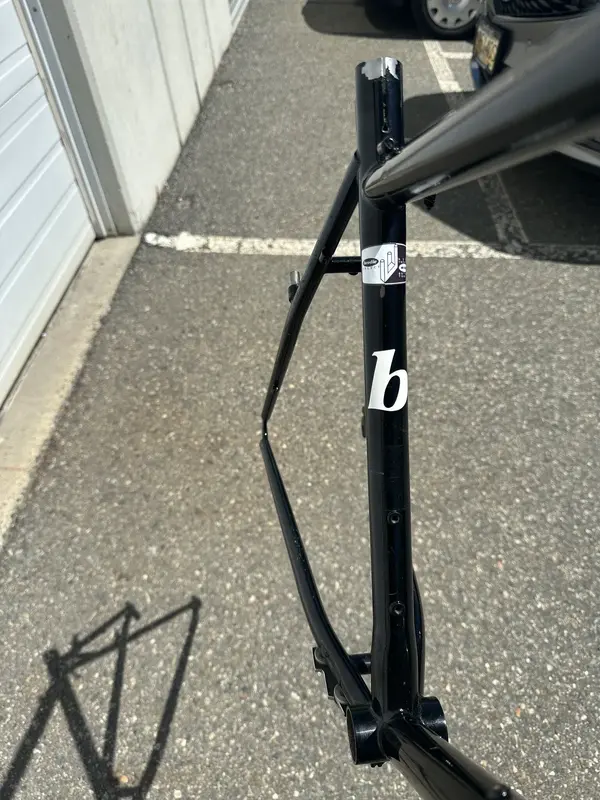

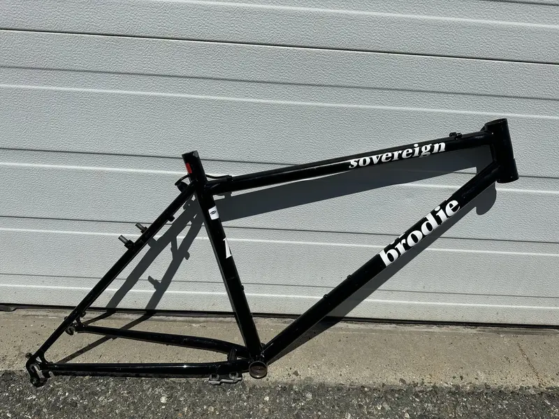

Took almost 3 decades but I finally got my hands on one of these....Brodie Sovereign with Gatorblade fork
canuckinboston

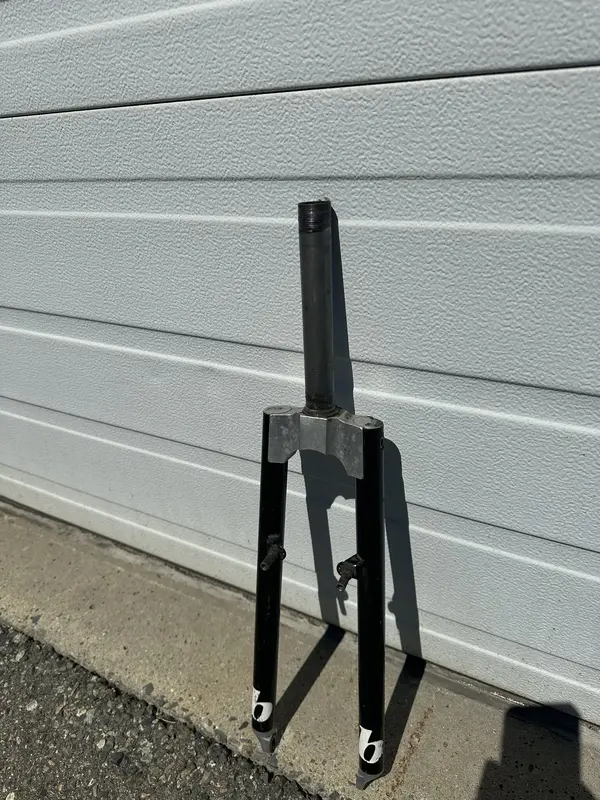

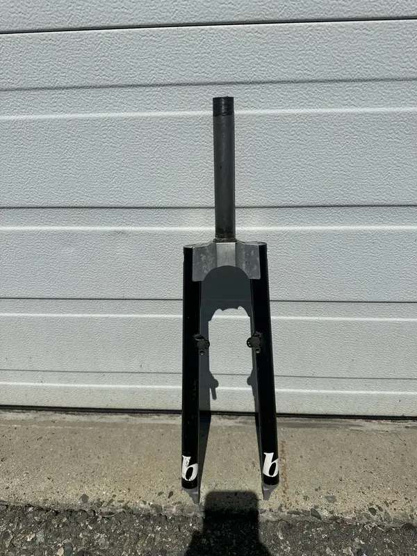

I picked this up in my neck of the woods. Unfortunately its going to be a bit of a project to get the Gatorblade fork (which was acquired separately) to work with the frame. Frame is a 1 1/8 head tube, fork is a threaded 1" with a steer tube thats too short. Happily Chris Dekerf's shop is in my city and he's going to make it work for me.....the process will be a bit involved though. Also although the paint looks great there is rust under all of that and therefore may need to repainted (had already been repainted once with new decals from Jim Nielsen); again, Chris can do this...

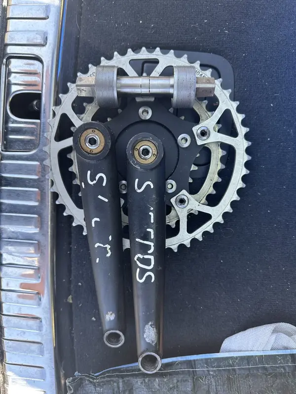

I'm going to go with XTR M900 groupset, Syncros revolution cranks (will be refinished) and Syncros post. For wheels I am going to use the Mavic 618 rims with Ringle hubs that I was originally going to put on the Klein.
Will keep you guys posted.

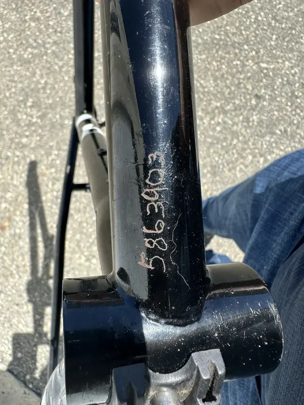

Very nice :cool: Do you mind sharing the serial number?
I couldn't see it when I flipped the frame over. However if I do end up repainting it I'll have Chris grab it for me. BTW: if I do go for the repaint I might go with another colour. Thinking either a Kandy Wild Cherry or an attempt to replicate the Klein Sea and Sky green/blue...
