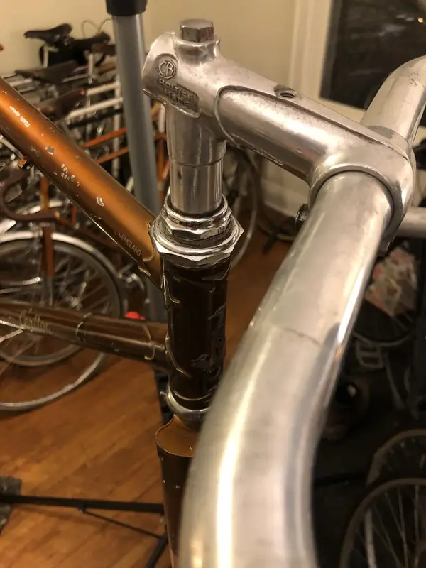

I have a 70's vintage Favori/Ellis Briggs frame and fork gifted to me by a friend. When I recieved the bike i noticed that there was insufficient thread on the fork to mount a standard headset with lock washer (the headset it was equipped with has none). I wanted to replace the 70's dura ace brakes with Mafacs, but couldn't get them to work on the front because I needed a cable hanger. I gave up on that project after searching for a lower stack headset with no luck, but it still bothers me. Wondering what others have done in a similar solution. Taken the fork to a frame builder and had a new steerer installed? Something else?
Thanks in advance for sharing your experience / advice.

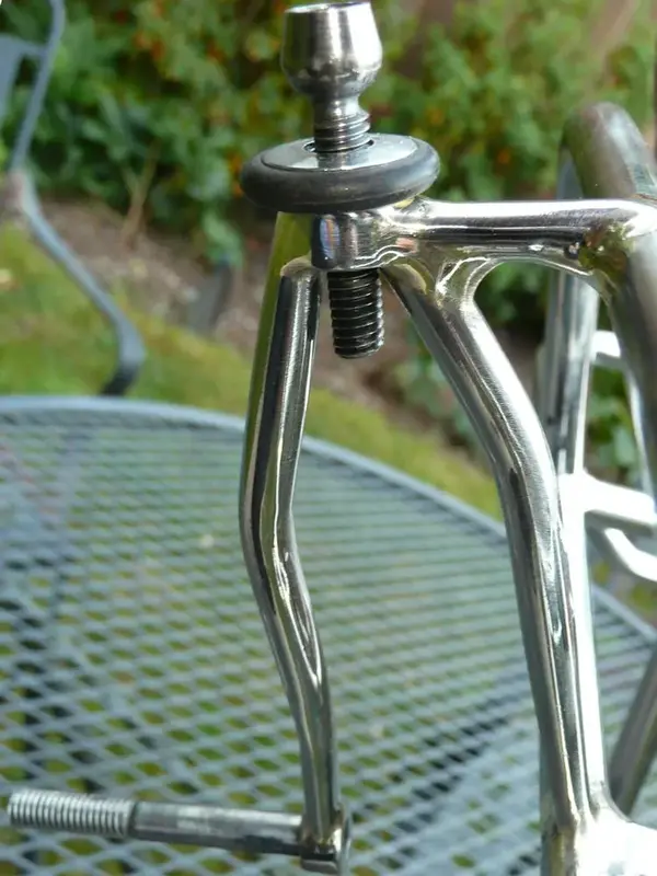

(1) Mill the head tube shorter by the amount of steerer length you need. Almost all frames have some extra "meat" there you can spare.

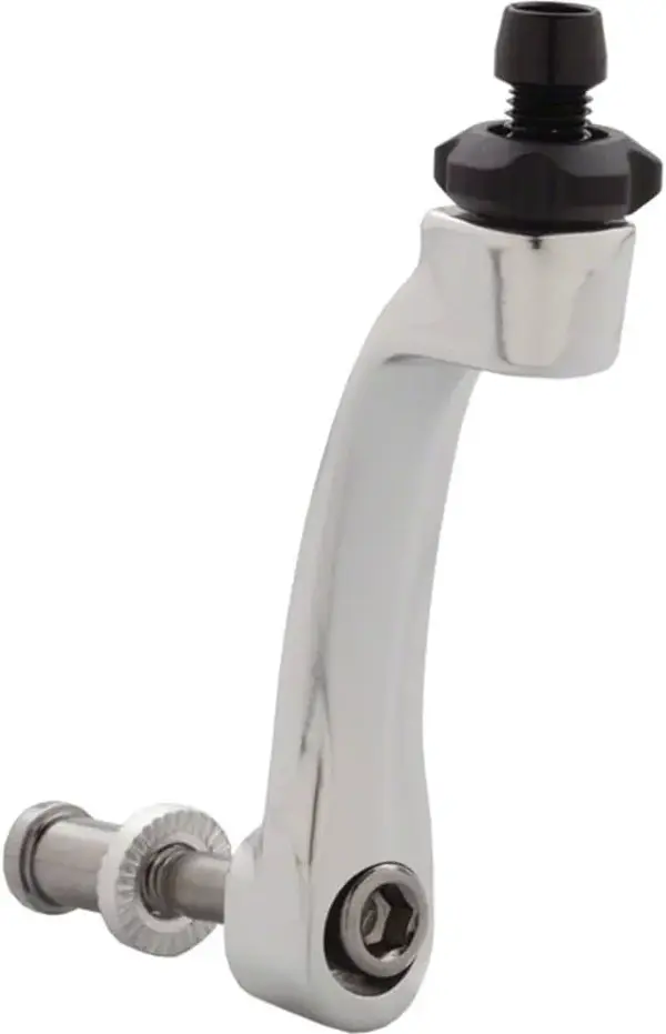

(2) use a housing stop that bolts to the fork crown.

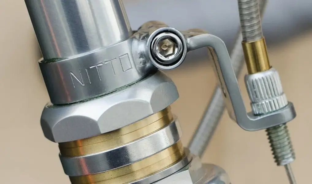

(3) use a housing stop that clamps to the stem quill (assuming it's a quill stem).
On second thought if you're switching from Dura-Ace, then you probablay don't have canti-bosses! Fix #2 is feasible only for canti brakes, without making one custom. You could probably fabricate one that would work with a Mafac centerpull, but I don't think the commercially-available ones will work.
I've made a couple that were integrated into a front rack, cool/trick but I've never seen one like that for sale, so this doesn't help if you're not already a rack-builder.

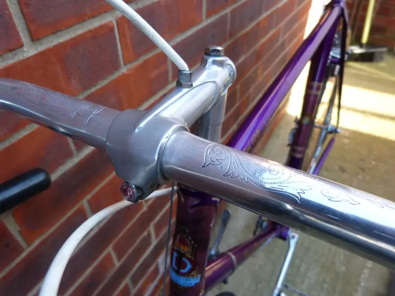

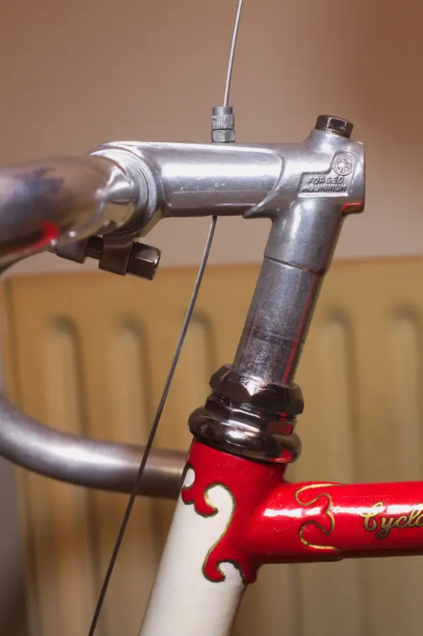

And to save 2mm you can drill the stem the way they did it back in the good old days.
Some people frown on drilling stems which I understand, but it works for me.
Also avoids any flex in the hanger so the brakes work slightly better.
1961 Holdsworth Cyclone with Tange Levin CDS JIS when I was drilling the stem.

I would struggle with putting a hole in a nice vintage stem like that, but it makes a lot of sense

I think I tried the fork crown housing stop, but it wasn't tall enough for the Mafac's. The clamp on quill stop would likely work. Interesting about the French HS stack heights - is it possible they built this to a French standard as I've had problems pressing in standard headset cups?

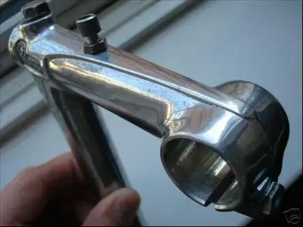

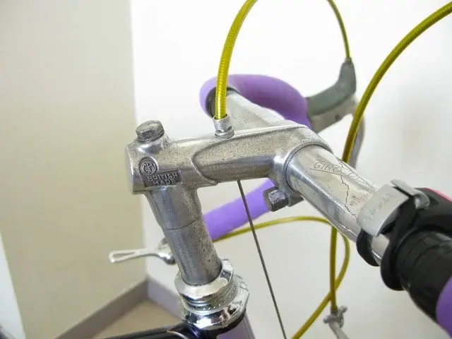

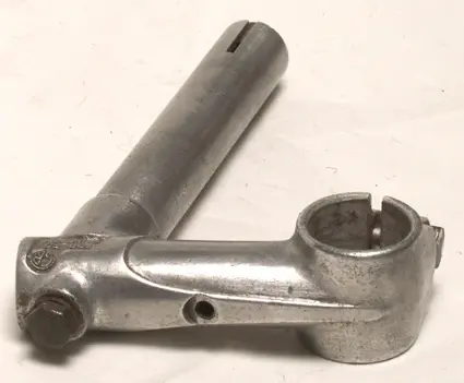

I prefer the stem hole to be drilled parallel to the cable direction, not perpendicular to the stem. That's how they did it BITD. With a little milled spot so the lockring on the adjusting barrel has a flat spot to sit.
