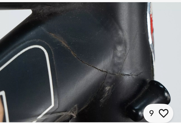

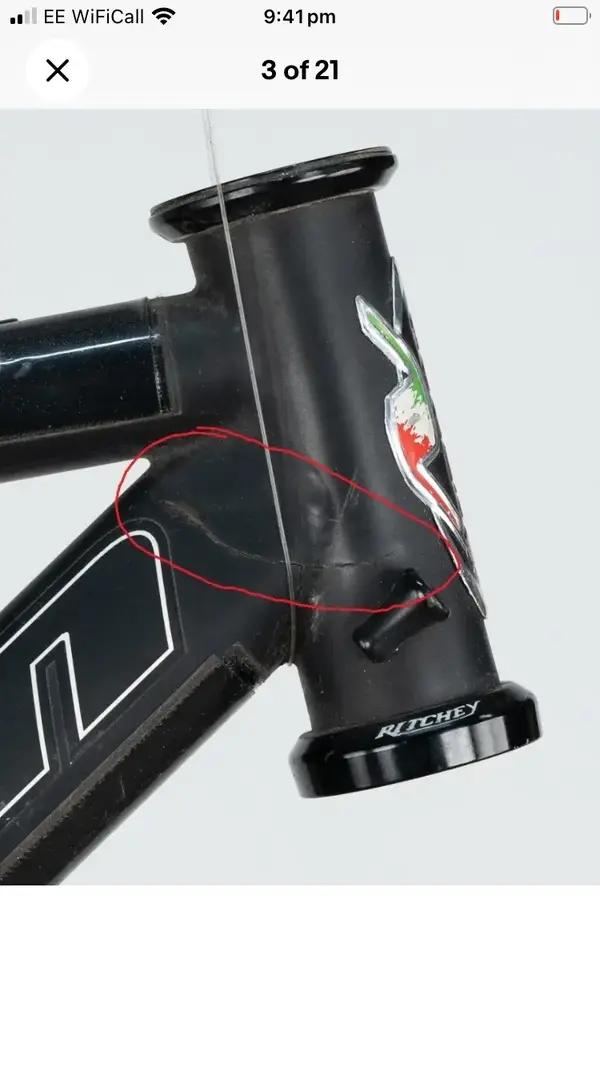

To repair or not repair cracked head tube
