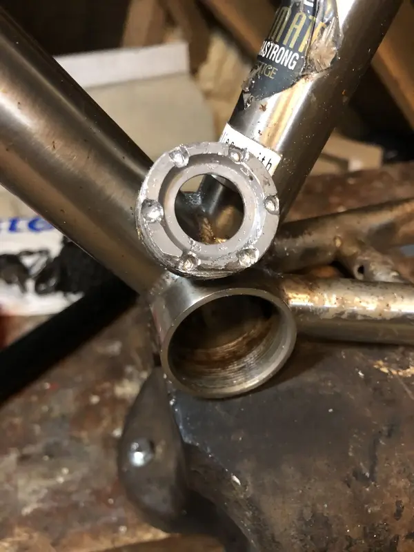

In need of a tool for this currently stuck and party butchered Titec bottom bracket.
Pin spacing is 15mm but the pin size is smaller than my Royce bb tool.
Anyone know of a tool to fit it?

Can’t you drill the holes out so that the Royce tool fits? I’ve had to do that before - you can also use a large bolt to lock the tool onto the cup (or the original BB with the tool bolted in place) and it should present no more problems!
Doesn't the Hope tool have thinner pins? or maybe try a pin spanner.

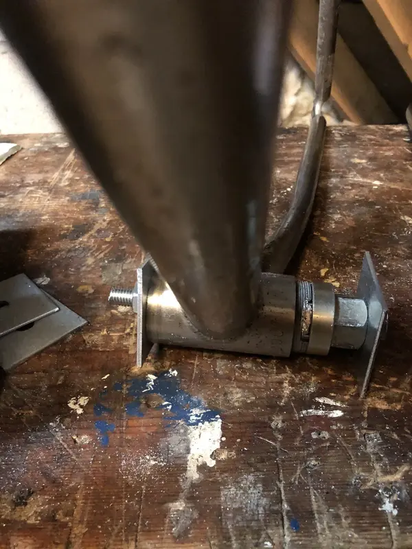

Pin spanner wouldn’t allow sufficient leverage (the cup was REALLY stuck), so went with drilling the holes out enough for my Royce tool to fit, then made a threaded bar/plate/nut arrangement to hold it in place.
A spanner alone didn’t give enough leverage, so used the handle from my car jack, and hey presto it’s out! :cool:
