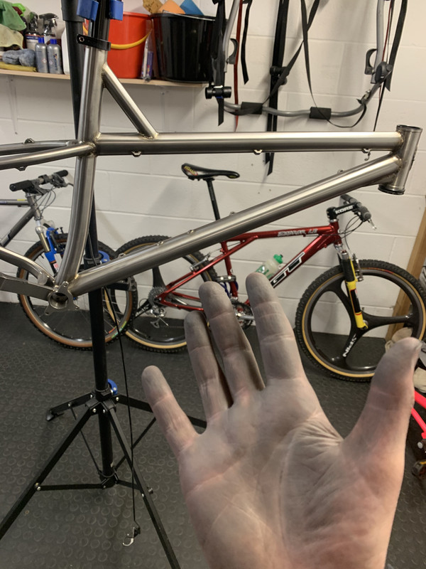

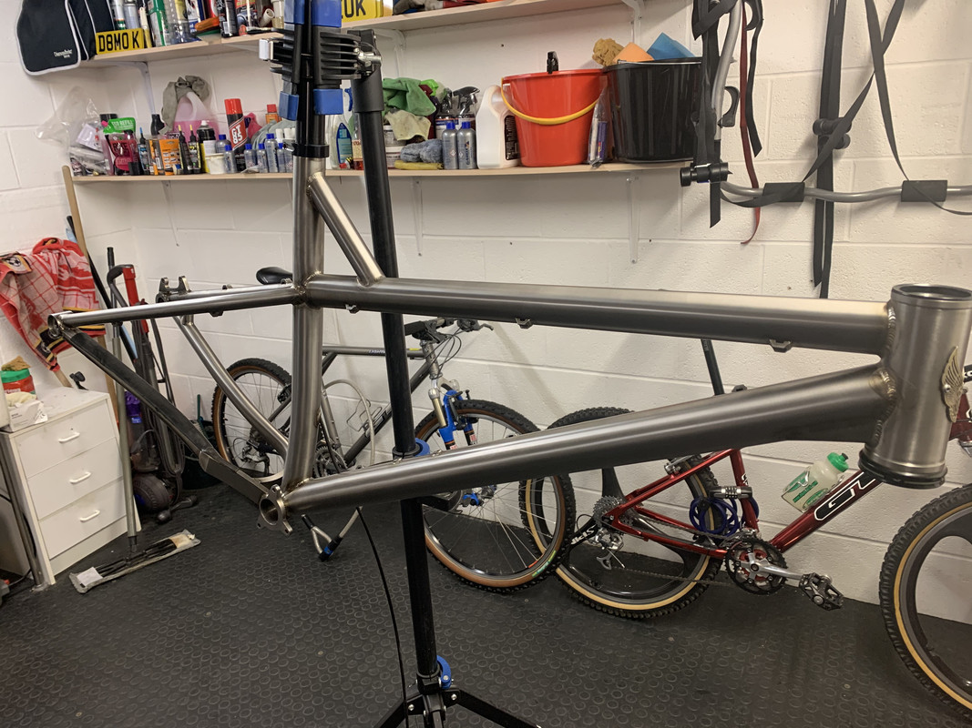

I’ve done a few Ti frames with scotchbrite pads and it’s fairly easy. Just make sure you rub in the direction of the brushed finish. And make sure your frame is brushed in the first place. Once done use GT85 on a cloth to get all the black crap off the frame
Re: Re:
Top Man, do you wet the pad or do it dry?
Thank you very much!
Dry.
It will Create lots of black dust so I now do it outside. Start at one end of a tube and work along. It’s quite therapeutic actually. Once happy GT85 on a rag but wiping in same directions as before.
