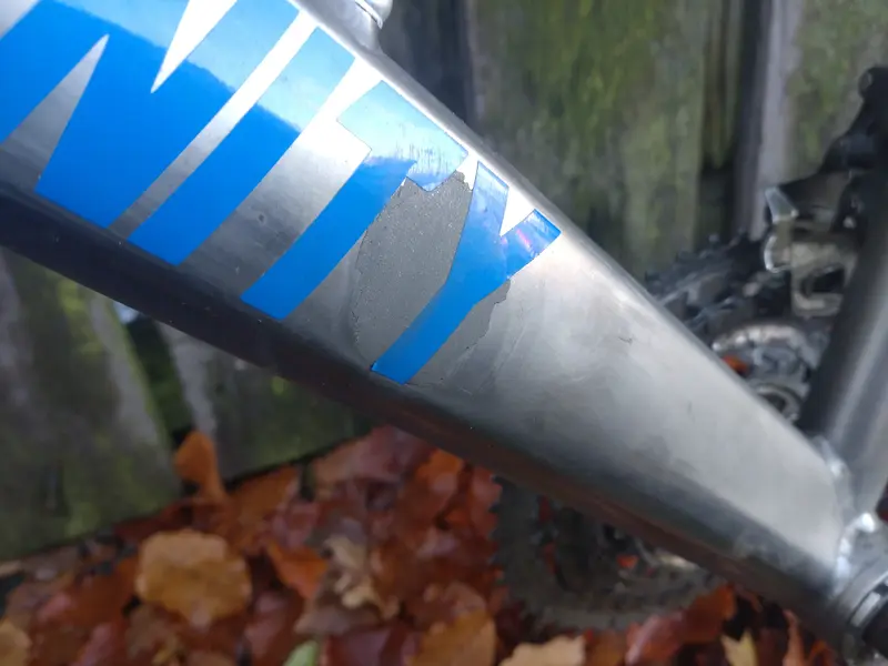

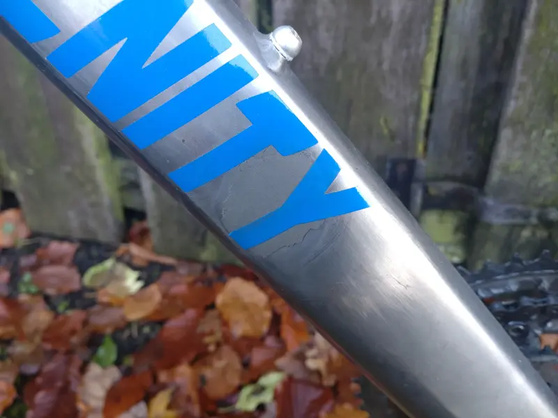

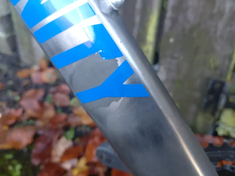

I recently picked this up from an auction for a reasonable price, certain it's a Merlin Rock Lobster Ti with stickers. In the photos I could see something going on with downtube which I thought might be a crack. On close inspection it looks like a thin coat or maybe filler. Anyone have an idea of what it might be before I start picking at/removing it, I'm thinking it might be a dent filled in. The integrity of the frame as a whole looks good.

It's filler
Hopefully just over a dent -
It's an unlikely place to crack, and you don't fill cracks anyway, so there's no reason to think it's anything more.
It's also a popular location for large dents, where the bike falls against a Sheffield stand.
If you removed the filler, you'd most likely want to fill the dent anyway, as it's not an easy shape or location to pull out.
This sort of damage heavily undermines a frame's value, but won't change the weight (much) and is unlikely to affect its rideability.
There may be some effect on reliability, as the dent will create stress risers at the edges, but old frames often carry invisible stress damage anyway.
Great for a rider 😃
Poor for a collector
That 100% looks like some metal filler to me. You can see bits glistening in it and around the fill looks like some wet and dry has been used to key the metal.
