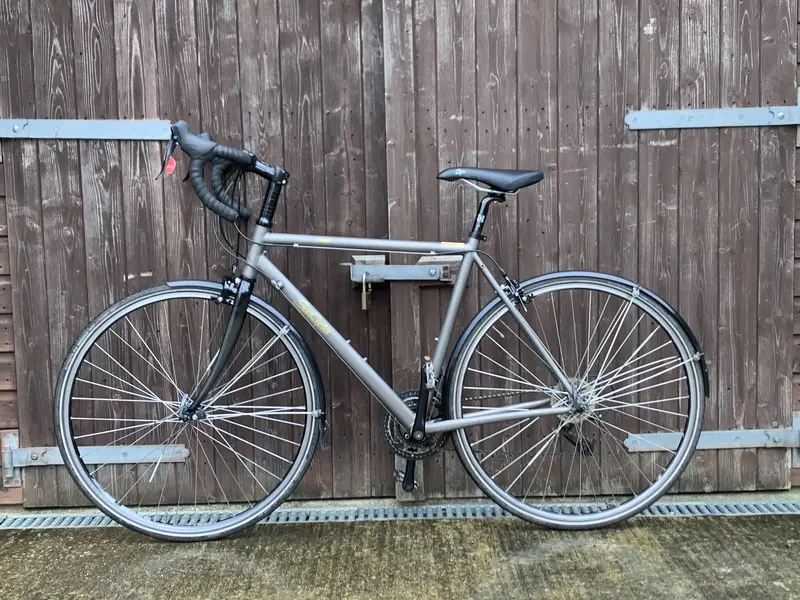

Am now the happy owner of a Spa Audax!
Thanks for the photo pigman, it was great to have confirnation that downtube shifters would work before making the trip.
Apart from adjusting the riding position I'll ride it over the next few months then 'make it mine' over the summer.

First chance for a proper ride today and what a lovely bike! Not keen on the SRAM double tap thingies but I'll be swapping them out anyway.
I could do with a shorter stem (I think) but will start by fitting downtube shifters and traditional brakes/hoods first as this will bring my hand position in a bit anyway. A shorter stem may well follow but that'll be it until the summer. Looking forward to getting a few miles in and thanks for spurring me on to get it! 🙂👍
Not sure which DT shifters you have, but if you're using some where the baseplates are shaped to fit a traditional steel down tube, then the profile won't fit onto the spa's oversized, ovalised down tube. You are faced with 2 choices - buy flat, non-profiled baseplates or take a file to the ones you have and take the edges off to "widen" the curve and then mount them. I did the latter, as I couldn't find anyone with stock availability of the flat ones. Been working well for a few years now
I was obviously lucky! They are old Simplex ones and bolted straight on.
I ended up also swapping my bars over so I could use the shorter Ahead stem I already had lurking in a box and the set up is great.
