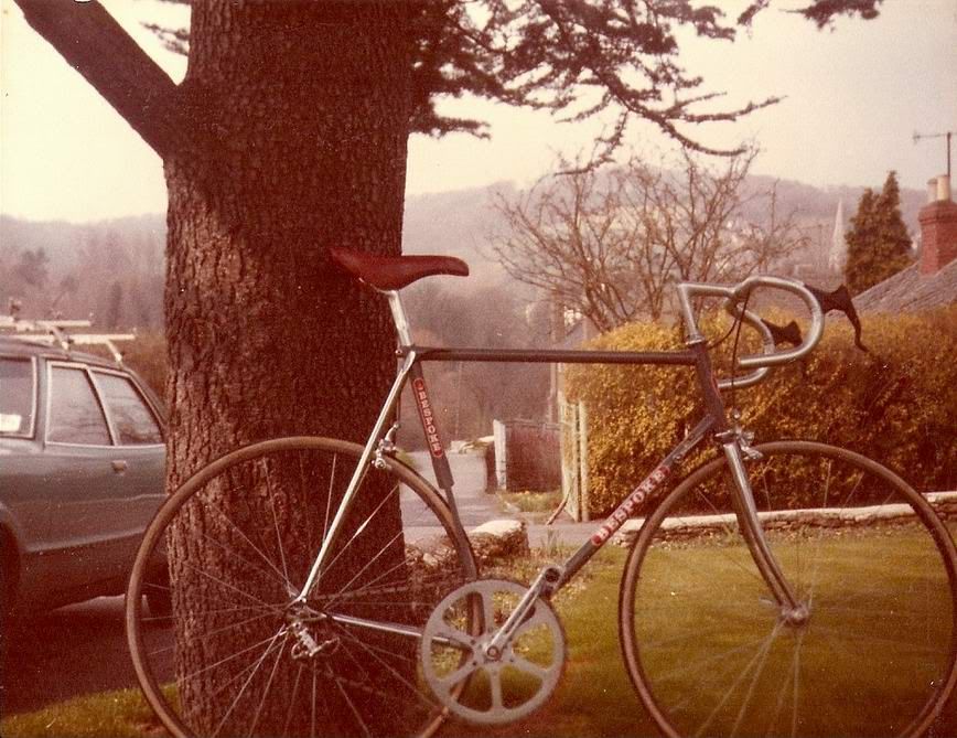

Here's a few pics of my own mid 70's TT frame that I raced in the mid 70's. Made by Kevin Sayles when he worked for Bob Jackson.
Generally by the mid 70's road frames were 74 parallel or 73/73 geometry, Fashion dictated that TT frames were 75 parallel or 75/76 which made for quite a lively frame :) The main tubes are Reynolds but the rear triangle and forks look Columbus to me
There was never any need for 10 gears so there was only a braze on for the right lever and the left side of the frame was blank, The Brakes were so close the Weinmann 500's had to be altered a little, Campag Piccolo struggled and to save weight the brake centre bolts were brazed to the frame. The fgork crown is cut down so as to be unrecognisable.
The frame was sliced / diced / chopped to cut weight. Aende cut the tubes and left holes or glued in x-ray film Mine is simply chopped :)
if you look closely the seat stay is not flattened for an inner ring and we had to use a double axle to get even the outer ring to avoid the chainstay.
The steerer was cut so short headsets never had enough room for spacers.
And then we drilled holes in everything we could.......
All in all, the only thing we did that was aero was to crowch lower and tape our laces over :)
