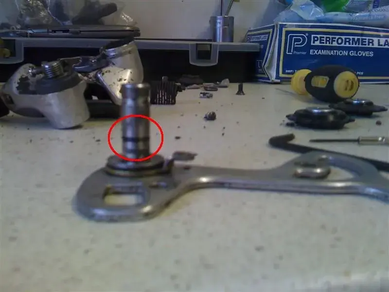

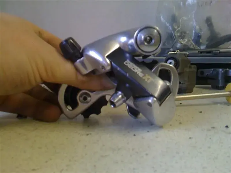

here ya go!
1 First remove the stop post from the arm and it will spin round.
2 Then at the back of the mech you will see a small phillips screw. Remove and then you will be able to remove the arm from the body
3 Make a note of where everything came from. Clean and inspect the spring which will come out the main body, and whatever else needs it! and replace the small o ring if it looks flat as this is causing a degree of play in the arm.
4 Re grease and replace spring and make sure you remembered which way it came out and also what hole it located on on the arm. Push the assembly together and replace the small screw which will hold everything together.
Hope it helps

Thank you Sir!
That's a great help to me and others.
No circlip then, just screws and a spring. The "o"ring you mention is the one that lies flat around the base of the pivot... right?
I suspect that is worn in my case, that's why making a plastic shim has removed some of the play.
You circled a black line on the pivot bolt, it that wear, or an "o" ring?
I'm tempted to strip mine down and fix it properly as you have done.

the black line is the o ring on the post. and the black plastic shim arount the base can wear too and help to develop a little play but most comes from the shaft as it is held together by the tabbed washer and screw.
