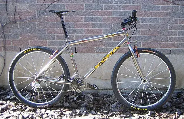

Especially bearing in mind that all Konas are total rubbish, I don't expect you'll think much of this picture of a ti Project 2 then Kev?

anthony, for what its worth, the few people I know who've ridden a ti P2 have said they are slightly more flexy than the steel version.
