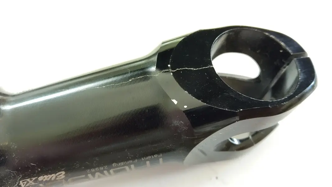

I realise im not going to get anything back, I just feel people need to know their items aren't as great as people think they are. I've been working on bikes for 30+ years I've worked in a bike shop and also have a torque wrench. The fact they kind of acknowledge there's a problem then surely they need to redesign.
Here's my stem. That is a nearly 2" long fatigue crack on the underside of the stem.😲
Luckily I had the bike upside down and noticed it.😳
(it's been in my toolbox for a while, I use it as a type of crown race setter now)

Thing is if I hadn't noticed this and say just gone down a curb, it could have resulted in disaster. I've got their seatclamps, seatposts and stems. Wonder how bad their handlebars are. I think they need to go back to the drawing board and re design, even if it means adding a bit of weight for safety
The cracks are terrible.
Thomson do use a very hard alloy so the it does c seem quite "snappy"

Funnily enough, carbon doesn't really 'fatigue' like aluminium.
somel aluminium alloys in particular weaken quite fast in use, looks like Thomson stems are up there.
witha carbon, the resin can break down if its cheap but as a rule if it didn't break, its ok.
