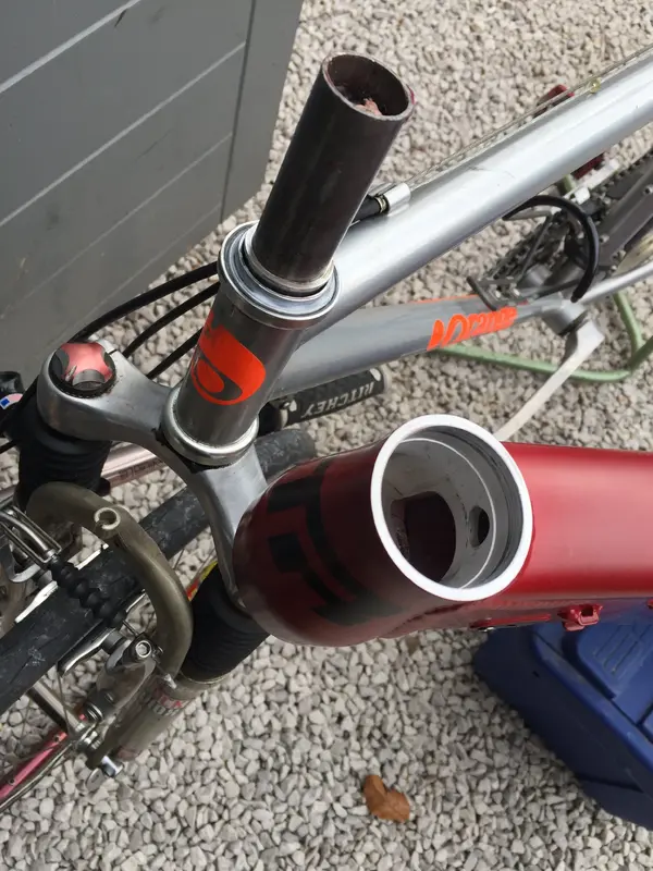

Arriving back after an excellent 30k loop, I decided to adjust the headset. And then thought - hang on, I fitted this in 1999 and have NEVER serviced it. Outside my flat in Brighton, I had installed a 1 inch DIaCompe Aheadset headset - the first gen - and then that was it. Thousands of miles ago. I think using a Headsock on the lower race helped a lot - stopped anything getting in there. And when I took everything to bits and degreased it, the surfaces were perfect. It's just been there, doing its job. I remember the first decade of mountain-biking...headsets were a complete pain. Almost impossible to find something of decent longevity. Mavic worked, but with that huge stack height you almost always needed to have a new steerer or forks. And the Dia Come just looks so weeny alongside a new enduro headset. See below.
But it's been fantastic. Just sucked everything up. So it was out with the races, a good squirty clean, then in with FinishLine and all back together....good for another 20 years?
