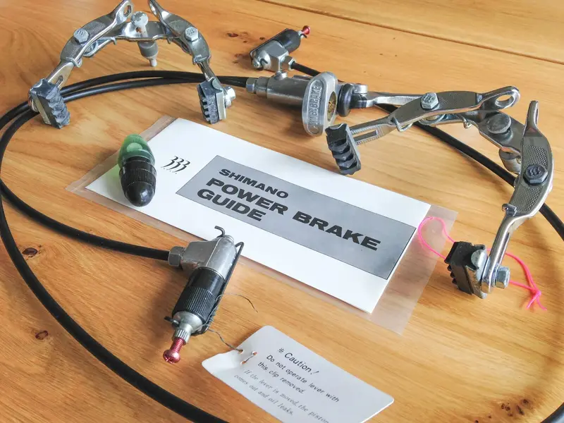

I had hydraulic discs in 1995 so was on point back then
Shimano have had disc brakes, hydraulic disc brakes since the early 1970's
Well that's interesting - its funny that they made such a big deal of disc brakes in the 90's if they'd been around since the 70's. I wonder why they didn't catch on - too expensive maybe? More brake than people really needed until they started to hurl themselves down mountains in the mud and rain?

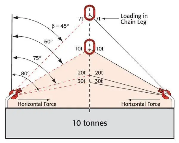

The major cause of excessive flex and ultimately failure on center pulls can be put down to straddle wire length. I currently use Mafac's which set up correctly work very effectively even when touring fully loaded. The vast majority of Weinmann brakes i have used or seen over the years come with a very short staddle wire as standard making them flex excessively. If the straddle wire is to short the force applied to the attachment points on the stirrups becomes horizontal rather than a vertical line pull. This horizontal pull will cause excessive flex and ultimately failure at the weakest point. The attachment point brake cable thingy where the straddle wire runs through forms an angel in the straddle wire, for maximum efficiency this angle should be no more than 90°. A similar action and reaction can be seen in crane lifting operations using slings too short for the lift.
By utilising the greater angles, you can have longer travel on the brake lever with lighter feel and better control over modulation. I use this on some setups, giving one finger braking without loss of performance but it does require more frequent adjustment, not everyday though.
