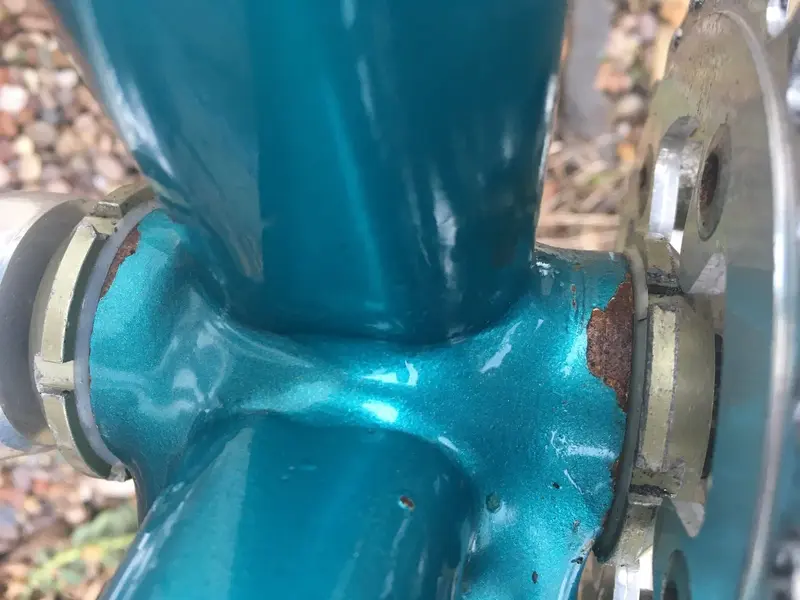

Now I have raised the issue of a respray before, and went with the populous and left as is, but I'm concerned that I'll reach a point where I might have some more serious issues. There are plenty of little spots over the bike, as you'd expect with the age and use, and I'm fine with that, but there is some more serious corrosion at the BB which is making me think it's best to get the whole thing done to keep it going for another 30 years.
I'd be grateful for some thoughts based on the attached pic and then a pointer re who to send it to if/when I send it off.

Hmm would be a shame to loose that lovely paint you might be able to get away with using a wire brush bit on a dremmel to cut back to clean metal then get the paint matched at a paint place with a uv scanner etc then touch it in. I did my kona recently with a bit of polishing the paint blended in really well.
