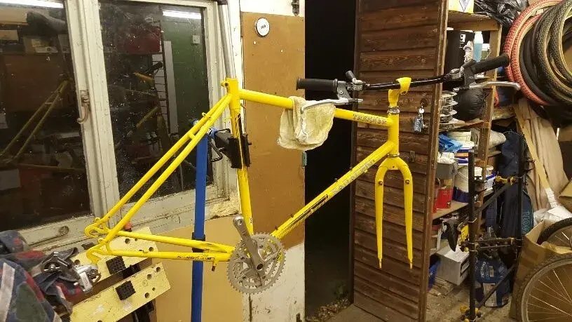

The mustard machine - Saracen Trekker 87

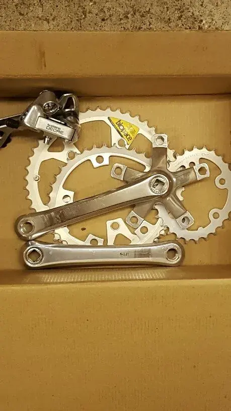

Interestingly enough the chainset is not mt60. Its stamped fc b 214. Which comes up on the Internet as a cheaper touring triple. I can only guess it's been on there from the start. Its nice enough and polished up well so will go back on, although ive misplaced one of the dust caps for now :facepalm:
Rings are early bio pace and very oval and actually quite worn
Rear mech is in quite nice condition probably because a guard was fitted, however jockeys were used to the point of being converted to ninja stars!

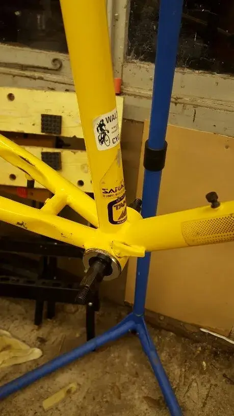

Cleaned up the bottom bracket and reinstalled but it still feels a bit rough. Will build it up and see what it's like in use but an upgrade to a un55 would be the obvious answer.
Alternatively I could dig though all the cup and cone bb I have and try and perm together something half decent, buy some new balls etc but not sure I can be bothered with all that when £15 on a new cartridge bb sorts it
That said will need to check axel length as I'm not sure it's the classic 122.5, it looks even longer

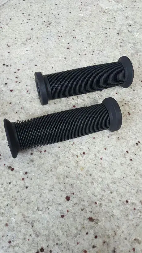

Grips cleaned up okayish in the dishwasher but were still a bit hard, so have just soaked them in a sink of boiling water and they have gone all nice and squishy again. So can be reused no problem.

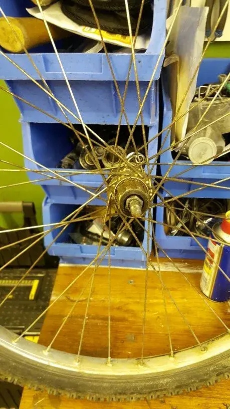

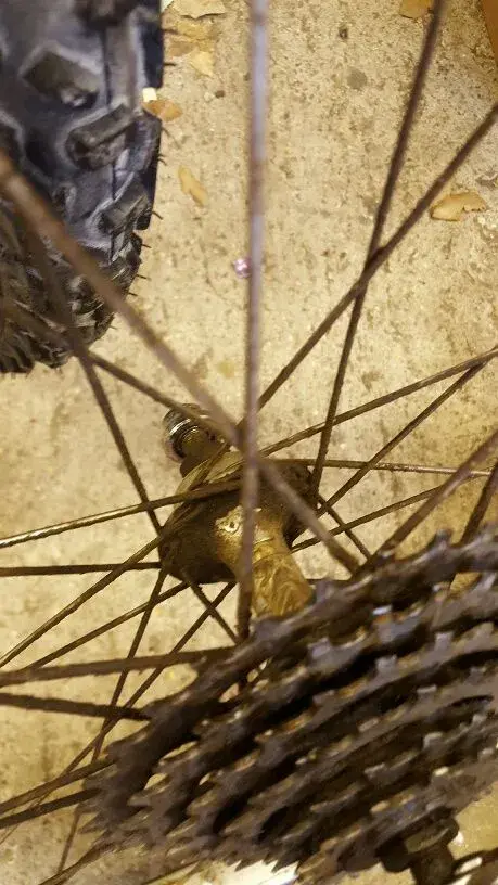

I'm hoping the wheels are in the same kind of condition as the rest of it - i.e. currently filthy but will clean up nicely.
The hubs are rotating okaish just a bit rough. But given the wear on the jockeys and chainrings, the bearings and cups may well be worn out. Having said that this is going to be a commuter/pub bike so i'm going to try and keep using what's there just a long as i can.
I started on them last night and made a bit of progress, the rear wheel is almost clean enough to pick up now! The front was always a lot cleaner to be fair.
Spokes are intact, straight and stainless, so should be okay. Will try and get a pair of amberwalls on there to from my tyre pile. wont be mint but hopefully look okay.

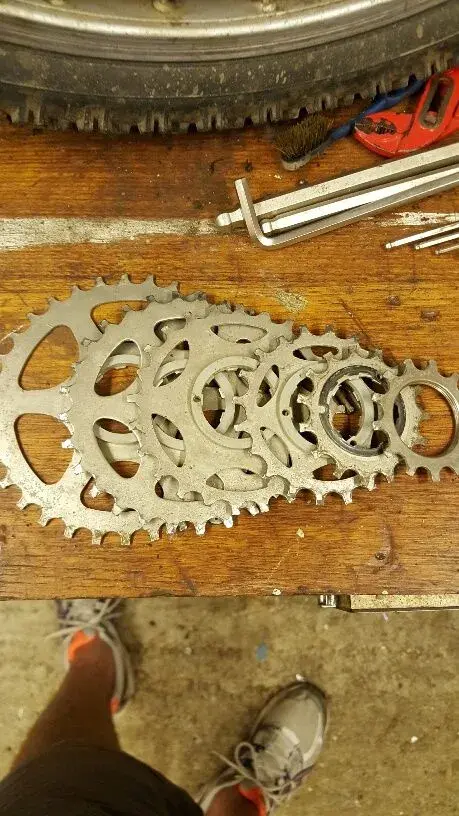

Clean it up a bit more tonight, managed to get the uniglide cassette off and apart! Go me.
