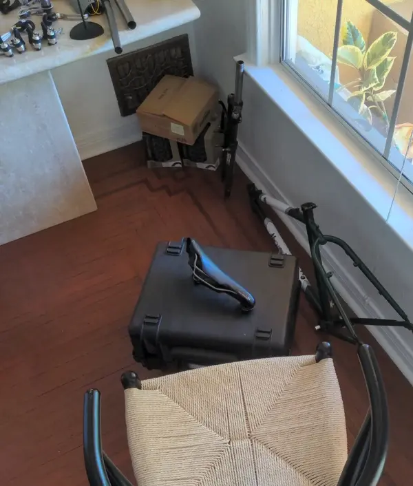

Love that perf Ti saddle! Yeah, keep me posted.

I did end up PMing you a few saddle links. The perf is a unicorn but my fingers are crossed.

You are welcome, nice picture. I'm frankly amazed that it was delivered so quickly.
Thanks and ya, you'd have though it was a turbo saddle 😑

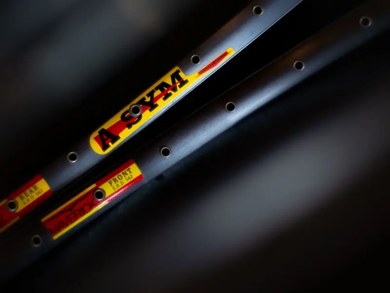

Love those rims and that photo! Are yours the ceramic versions?
How do you take those photos with the greyed out background? Looks really cool.
No, not the ceramic like yours. Yours are even nicer! Hope you soon show them to us laced to your white industries hubs you did that nice work on. I got lucky snagging these from two different sellers on ebay. One had a bad photo and looked like it was a bright silver finish so I was a little uneasy about them matching. Thankfully they're perfect.
The first pics of the frame were with a cell phone which I loathe. I'm holding off starting another thread for the early OR/black bike until I can get some ok photos. All of these with the black background I shot with an old Ricoh digital camera with one of two lenses. The background is just a pelican hardcase and I used window light. Time of day is everything, some shots are better than others.
