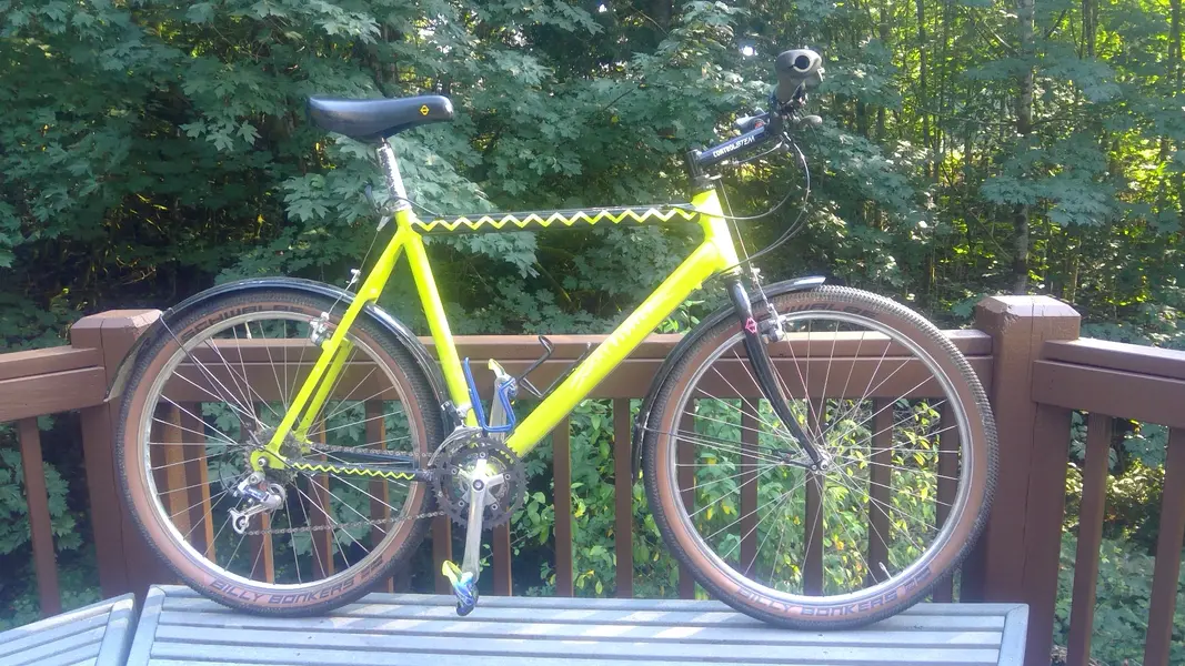

I do not ride off-pavent often - every time I think about a drop bar conversion for my 1991 GaryFisher = can't pull the trigger. It has had narrow Tom Richey slick tyres that measured ~30mm, Kenda 1.75" (~44mm), and presently Schwalbe 2.1" (54mm). And what a huge difference each makes. It is the largest frame SuperCaliber in '91. 71° HTA makes sure it is not overly quick handling at slow speeds, and 42cm chainstays keep it nimble for maneuvering/stiff for accelerating. Handlebars/stem can be changed to suit one's best position/use.

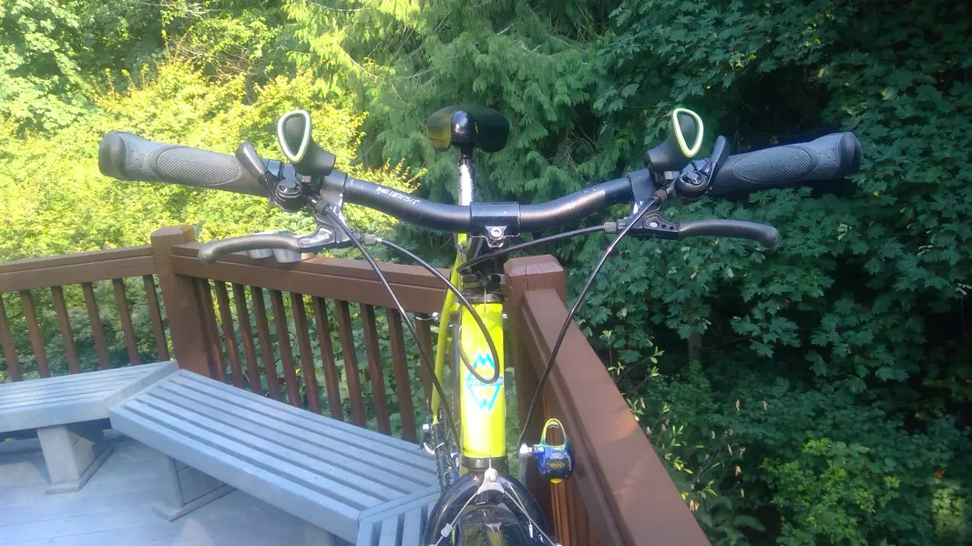

Here is an example of versatility - maybe lacking enough eyelets for some. Last pic shows inner 'bar ends' allowing vertical wrists and narrow position for pavement or hardpacked trails.

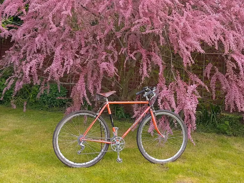

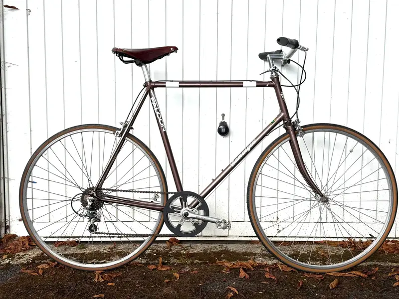

The only bike I have atm that fits that niche is a Falcon Carmargue with a 501 frame and I am not sure if that was originally a drop bar that has been converted many years before i got it.
1980ish fast tourer built for closer clearance 27" but with 700's .....
Not an easy find frame wise but worth the wait , nippy but stable
