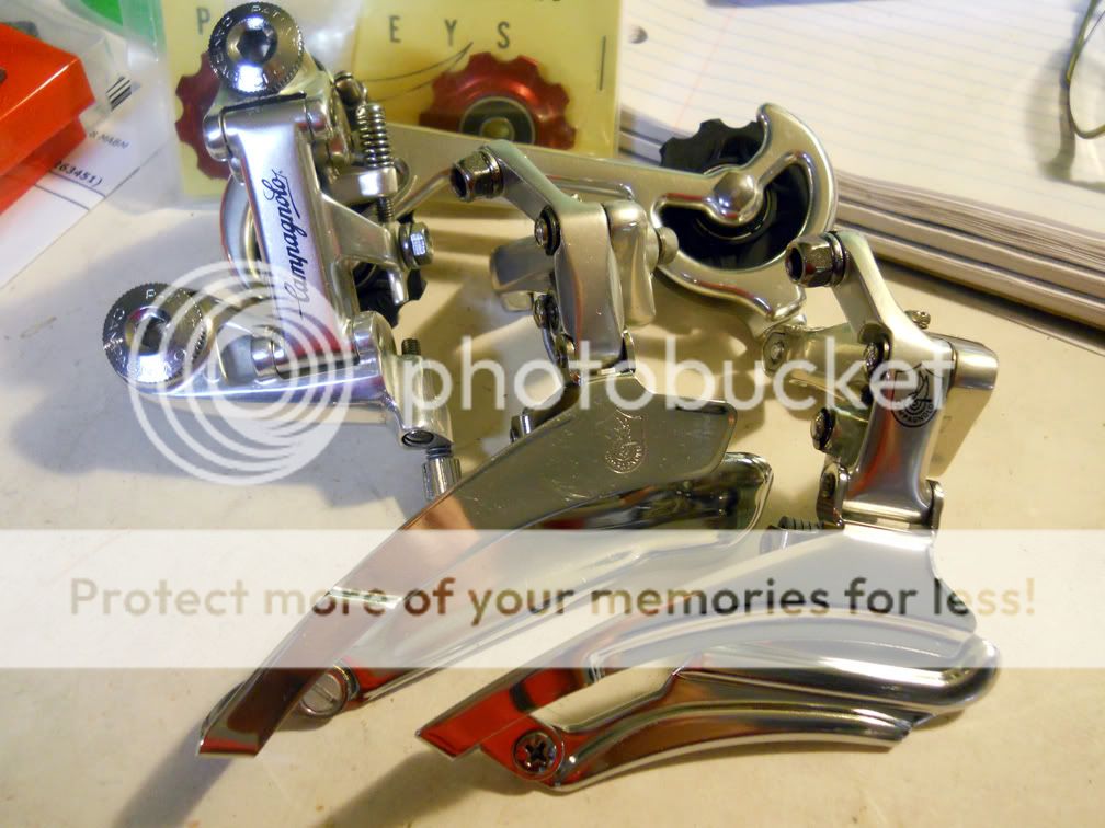

The rear is a 3rd Gen Rally, but the front is the Record O.R. triple on the right. The 2nd choice was/is the Euclid there.
Adjusting the thing has been a headache, not to mention my terror of over-tightening the clamp to crack the finish. The electrician tape on the inside of the clamp was a disaster, as it smear and slid. I cleaned it off and went naked. So far, so good.

The crank is a NR that Bob Freeman at Elliot Bay in Seattle triplized for me. An SR outer ring makes it look less bulky and more elegant (IMHO, of course).
The new chain and ramped freewheel help, but that rear shifts like butter!

Here's a snap of my solution to the FD guide. I cut off the other side of the clamp, as the braze on is there for the rear.
