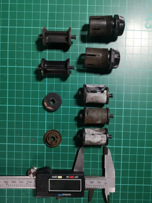

Hi, Dou you have a set for a quadra 21R rock shox please? probably mediums? 93kg.. Can you give me a price including shipping to Belgium?
I thought I saw this before earlier in this thread. In 2018 you supplied Charly for the same shock. Do you not have that specs anymore?
Hi there. It looks like the rock shox quadra q21r has 8no 19mm diameter elastomers @ 25mm length (measured in used state) could possibly be 26-27mm in original unused state.
Let me know what you think.
Then its just perfect. Mine is 19mm outside diameter, so original size. Length is a bit more, but that means you use one less (or cut one)
I sell 6 for £20 and 10 for £30 plus there is £8 for shipping.
Yep thats fine.
4 would be then 156mm per leg, confirm if thats good
