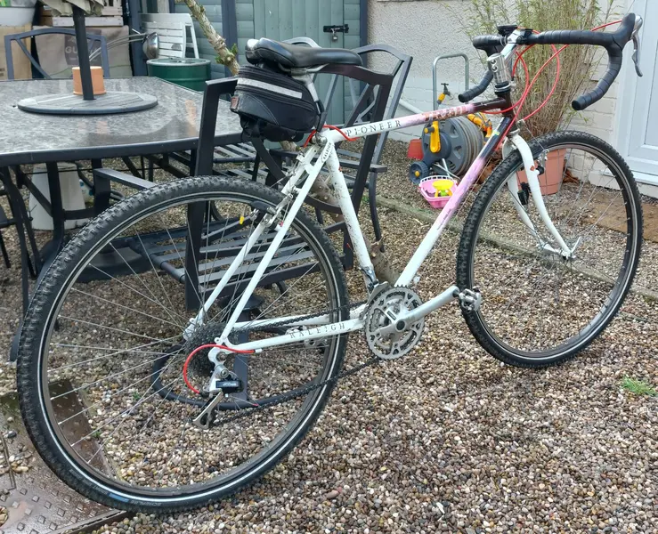

That is very niceMy old Raleigh Pioneer trail from 91, the original 'hybrid', swapped a few steel bits for lighter alloy, popped on drops and rx100 brifters, it works a treat!View attachment 951407

Nice! I love an early lugged hybrid.My old Raleigh Pioneer trail from 91, the original 'hybrid', swapped a few steel bits for lighter alloy, popped on drops and rx100 brifters, it works a treat!View attachment 951407
Definitely so, it does everything I need and keeps up easily with modern stuff at a fraction of the costThat is very nicethe Pioneer is an underrated bicycle imo.

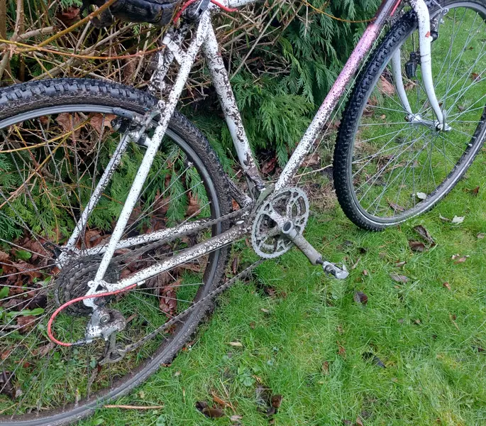

Got any drive side pics?Definitely so, it does everything I need and keeps up easily with modern stuff at a fraction of the cost![]()
Got any drive side pics?![]()
Now running an stx rc as the original derailleur cage got bent when it picked a stick up, ultimately I'll pop on a Deore Xt to match the front...when I can find one in decent nick and long cage.Got any drive side pics?![]()
Proper muddyNow running an stx rc as the original derailleur cage got bent when it picked a stick up, ultimately I'll pop on a Deore Xt to match the front...when I can find one in decent nick and long cage.
These are Smart Sam 700x 40, pretty sure it'd take up to 45...possibly a tad bigger? It's a 1" quill to 1 1/8" threadless, not sure of stem but it makes changing bars etc far far easier, three 10mm spacers ease the flow from quill to ahead l think!What is the biggest tyres you can fit? I need to find one of these or other Reynolds tubing bikes. Edit, is that an ahead/quill converter?
They do, almost seamless. The one thing that's put me off in the past. Removable face plate is a great idea. I bought a velo orange one for my Randonneur, the most money I've spent on a stemThese are Smart Sam 700x 40, pretty sure it'd take up to 45...possibly a tad bigger? It's a 1" quill to 1 1/8" threadless, not sure of stem but it makes changing bars etc far far easier, three 10mm spacers ease the flow from quill to ahead l think!
