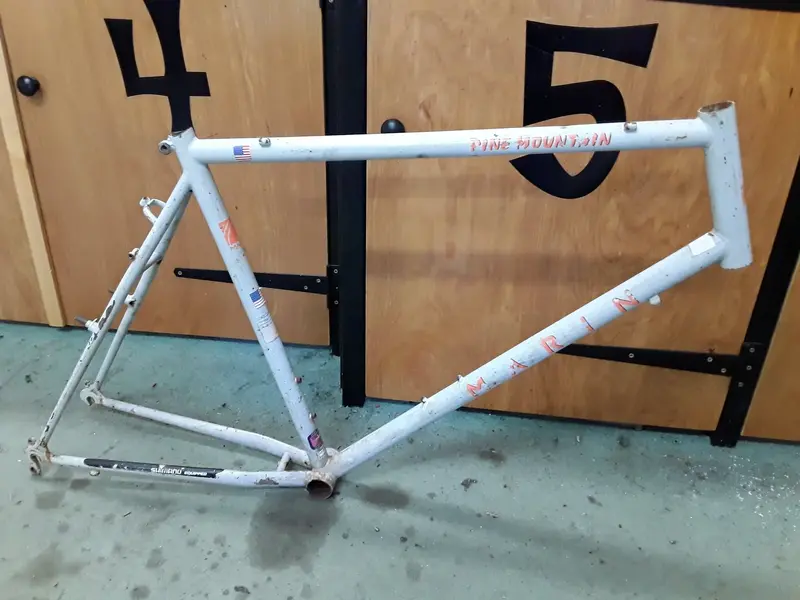

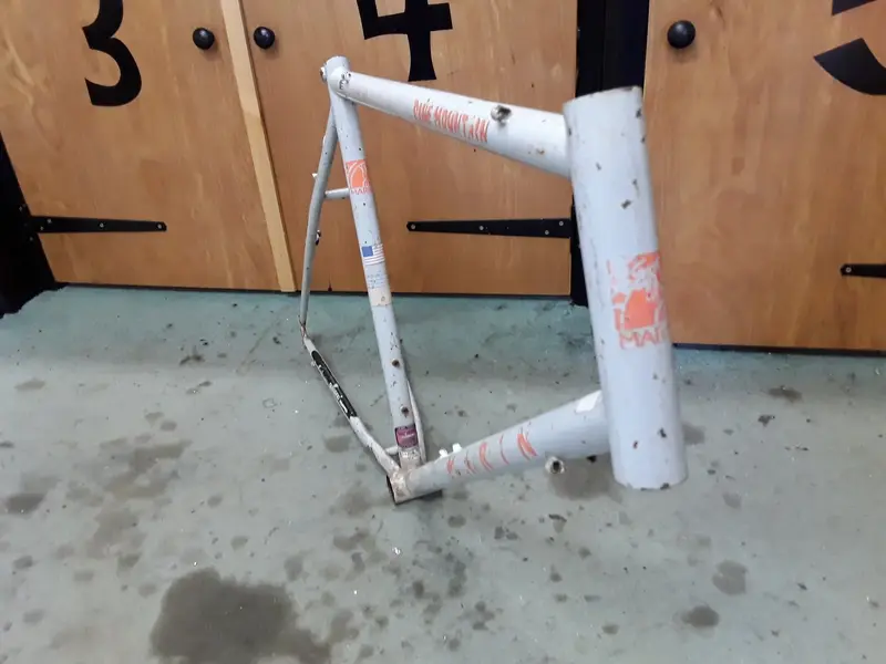

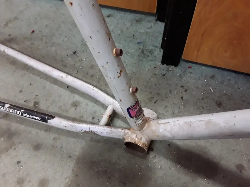

Luckily just as my musings were taking shape, a chance meeting brought me a perfect start in the form of an 89 pine mountain 20.5"
Its a bit crusty and has been in storage for 9 years, but its was cheap and came with a few extras which my help.
Its going to need some work, but hey....thats the fun bit.
