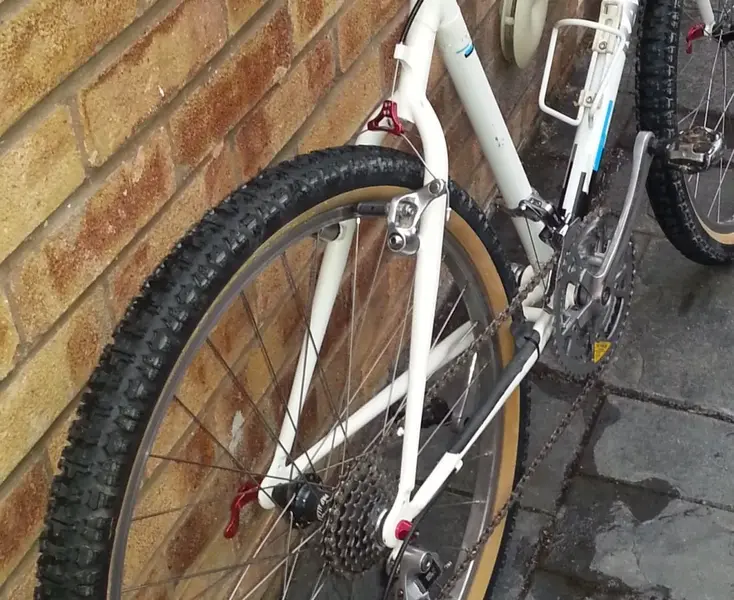

Agree there's probably not much in it, more to do with cable/lever setup. But if you're after VERY cheap and good, I recommend Deore cantis, 90-ish vintage. Low profile (so won't catch your ankles), easy to set up with grub screw tension adjuster, and IMHO they look the nuts when polished up.
Only slight trouble I had is getting toe in correct using 'road' Aztec pads - because the Deore canti has slots for bolt in pads as opposed to the more common post-type mounts.
