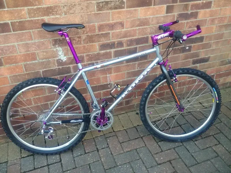

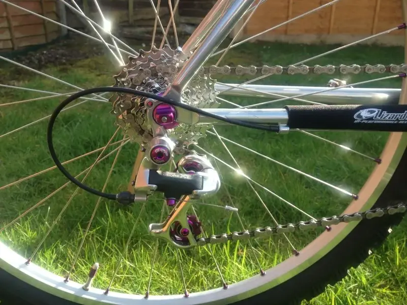

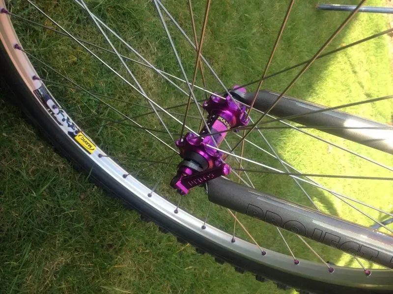

Finished the 94 Kilauea build today
   Going to take it for a spin tomorrow
here's a few pics while it's all shiny and new before I cover it in crud
Spec is Purple!
as Follows:
Frame: 19" 94 Kona Kilauea
Fork: Kona TB Project 2
Headset: NOS Kona Control Centre (re-anodised purple)
Stem: 135mm Answer Atac (Purple)
Handlebar: Pace RC130 (Purple)
Grips: ESP Gripshift
Brakes: Dia Compe 987 (Purple) with rear NOS Purple Tektro brake booster
Brake Pads: Kool Stop
Brake Cables: Clarkes
Brake Levers: NOS Dia Compe PC11 (Barrel adjusters re-anodised purple)
Hanger: Kona P2 Cable hanger (re-anodised Purple)
Cable management: Kona Dog Collar (re-anodised purple)
Shifters: Gripshift X-Ray
Front Derailleur: Shimano FD-M737 26.8mm band Bottom Pull with Purple alu bolts
Rear Derailleur: Shimano RD-M739 Medium Cage with Purple jockey wheels & Purple SRP bolts
Derailleur Cables: Clarkes
Cassette: New SRAM PG850 11-28 with Purple Lock ring
Chain: New Shimano IG 70
Cranks: Middleburn RS3 (re-anodised Purple) With CD spider (re anodised purple)
Crank Bolts: Middleburn self extracting (Purple)
Chainrings: Middleburn Slickshift 32 & 44T with Purple 22T granny ring
Chainring bolts: Various (Purple outer set)
Bottom Bracket: 110mmx68mm FSA
Pedals: Shimano PD-M505 Spuds
Hub Skewers: Hope Ti (Purple)
Rims: New Mavic XM317 32H
Hubs: NOS Pulstar 32H (Purple)
Nipples: DT Swiss (Purple)
Spokes: Phil Wood Stainless plain gauge straight pull
Tyres: NOS Tioga Psycho K
Tubes: Specialized
Saddle: Black Selle Italia Flite 1990 Titanium
Seatpost: NOS Kalloy 27.0 x 350mm (Purple)
Seatpost Binder: Kona (re-anodised Purple)
Weight: 24lbs 13oz
