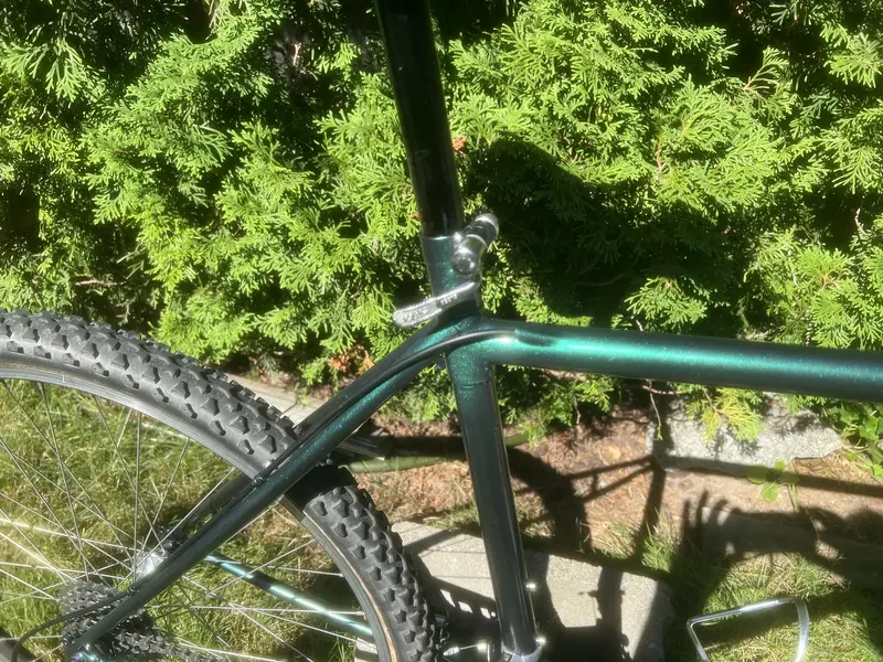

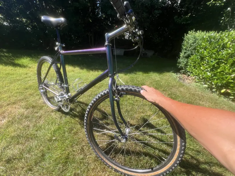

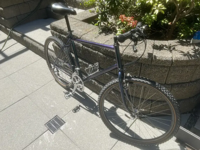

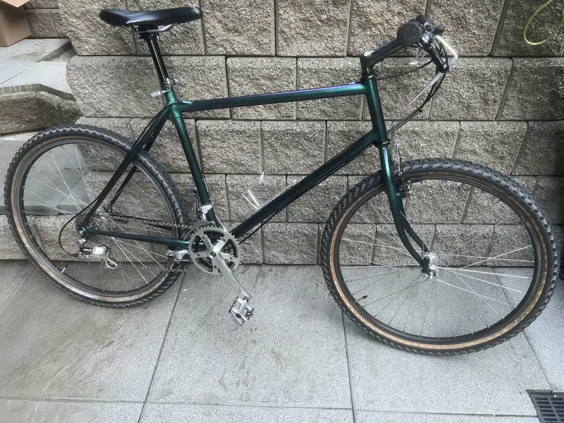

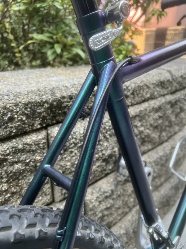

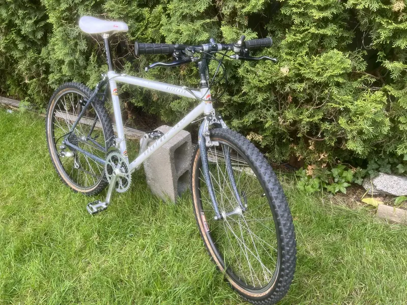

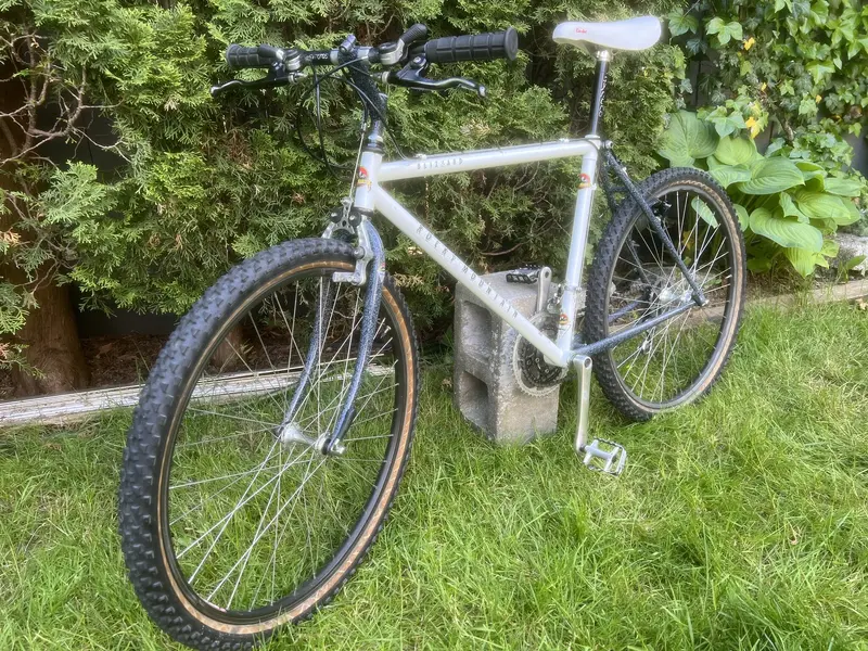

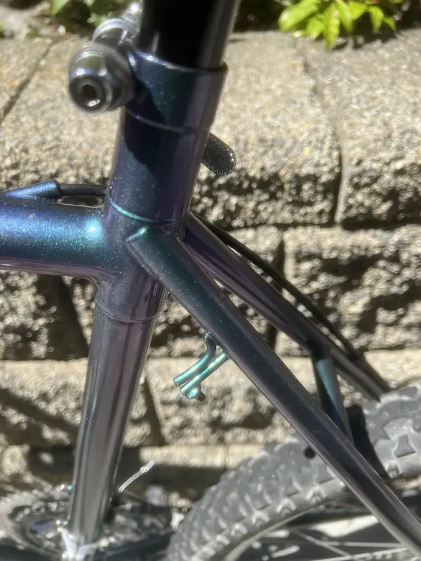

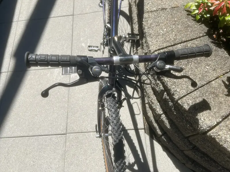

Here is the finished bike:
20.5 inch 1987 Brodie Romax with internal cable in top tube and Brodie pump braze on.
Shimano Deore XT group 7 spd SIS & friction shifting.
Nitto chromoly fillet brazed black chrome stem
Very rare “Black” Magura brake levers ( from Paul Brodie’s parts stash – Paul sold to me at the retro bike swap meet ). You can't beat Magura or Tomaselli brake levers on an 80s mountain bike ! These were motorcyle levers originally and then used on early mountain bikes. IMG_9567.webp

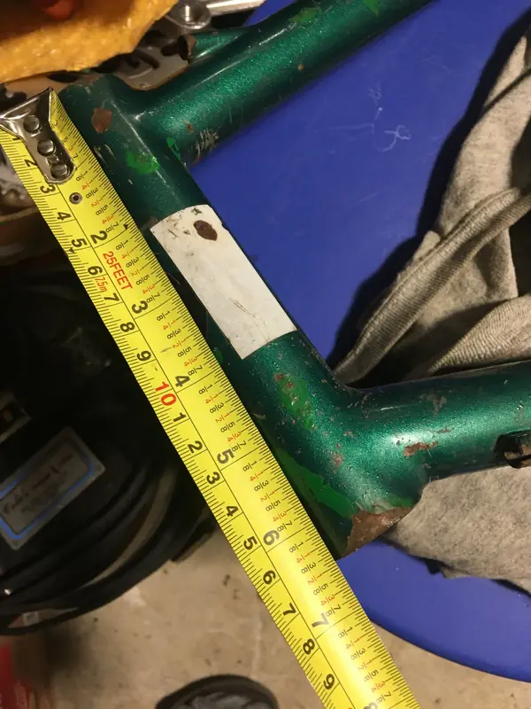

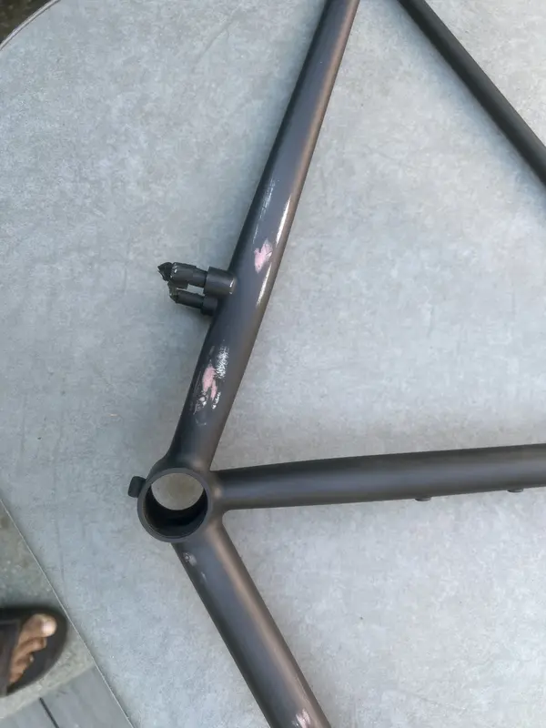

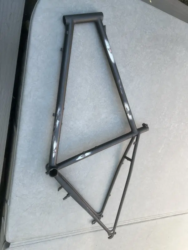

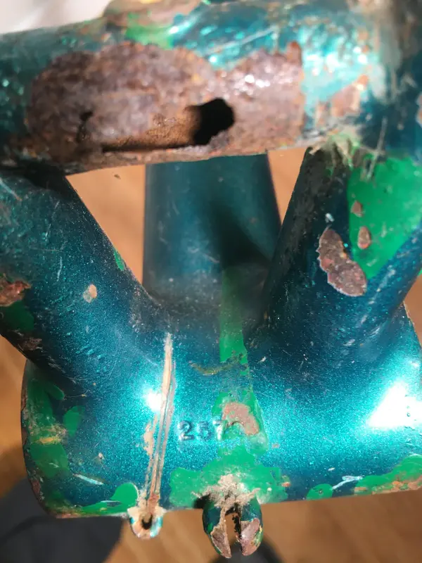

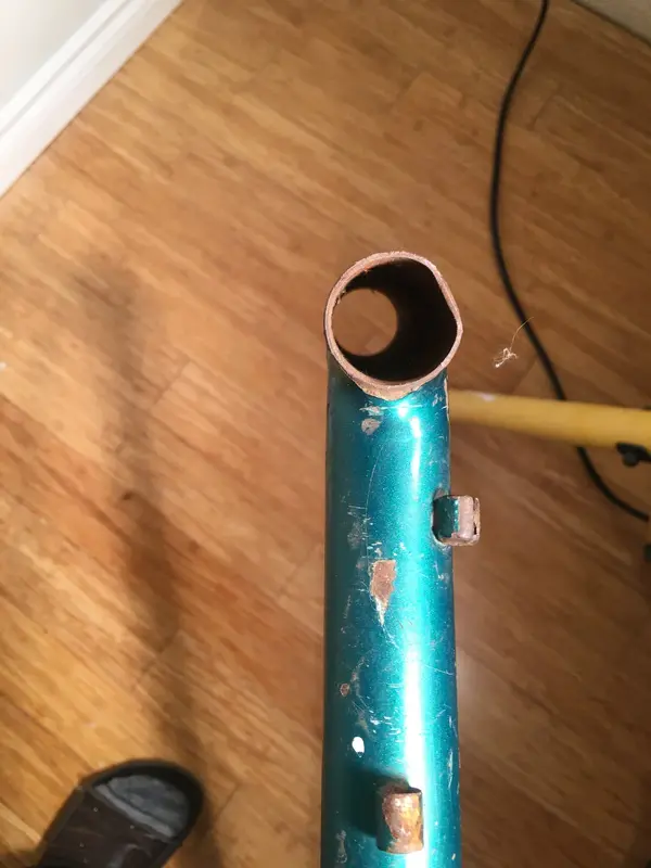

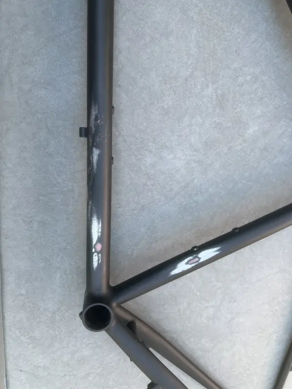

Original condition:
Here is the frame before restoration
Rusted chain stay brace ( water into fender screw mount ) but the rest of frame was solid
Crack in the rear dropout brazing

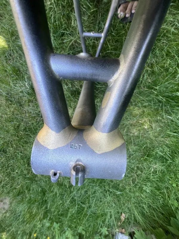

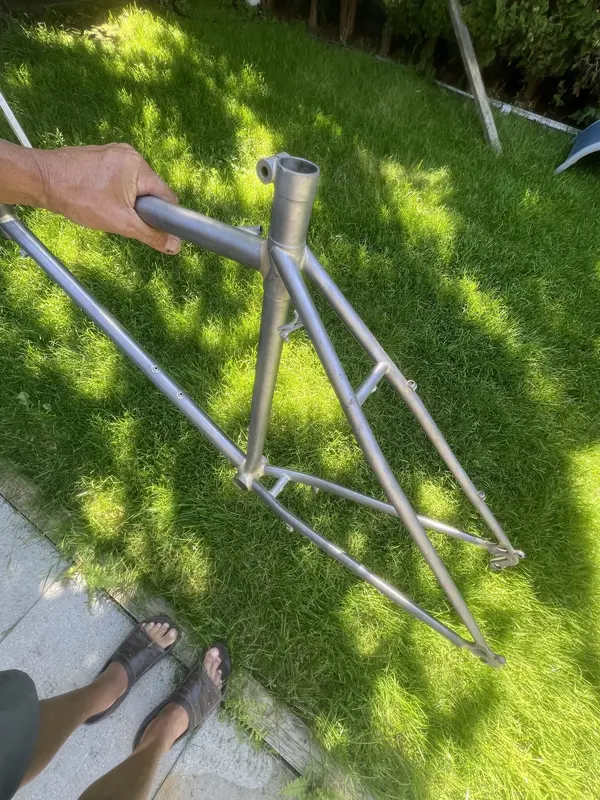

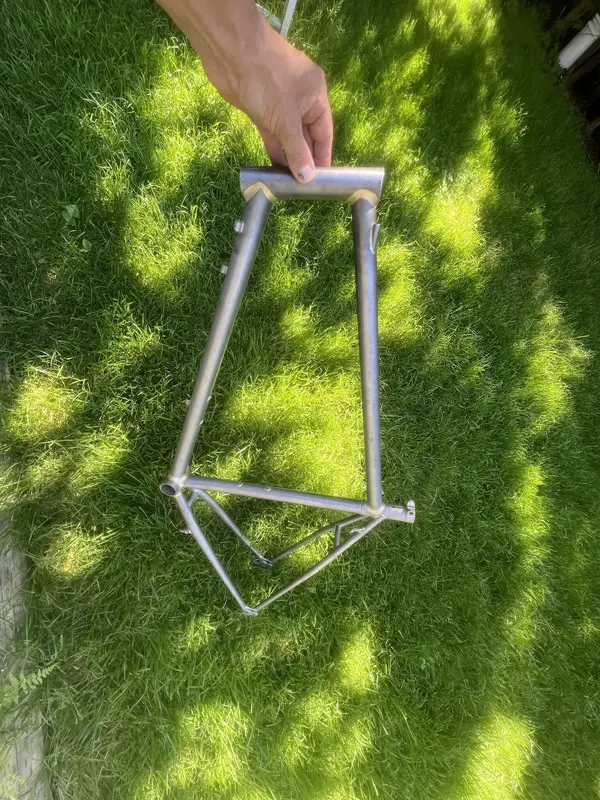

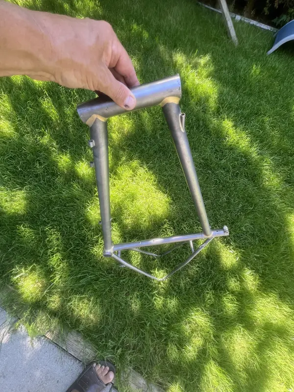

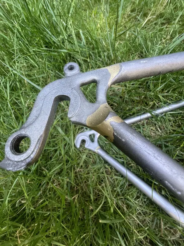

Frame Restoration:
Here it is after frame brazing restoration/ sand blasting .
The welding/brazing fix was an awesome job done by Toby at Toby Cycles Works in Vancouver ( builder of the Skull Skates Cruiser bike frames )
The frame issues/restoration is very similar to Ryan’s #Ryry_1985 #279 Brodie Romax Rescue with brazing fix done by Paul Brodie himself - you can't beat that ( there are Youtube videos of this ) , but I think Toby’s work is top notch quality ! IMG_9286.webp

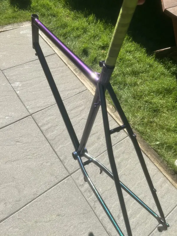

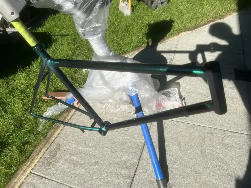

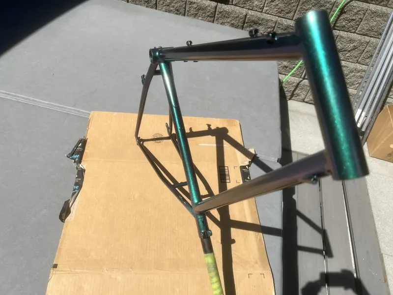

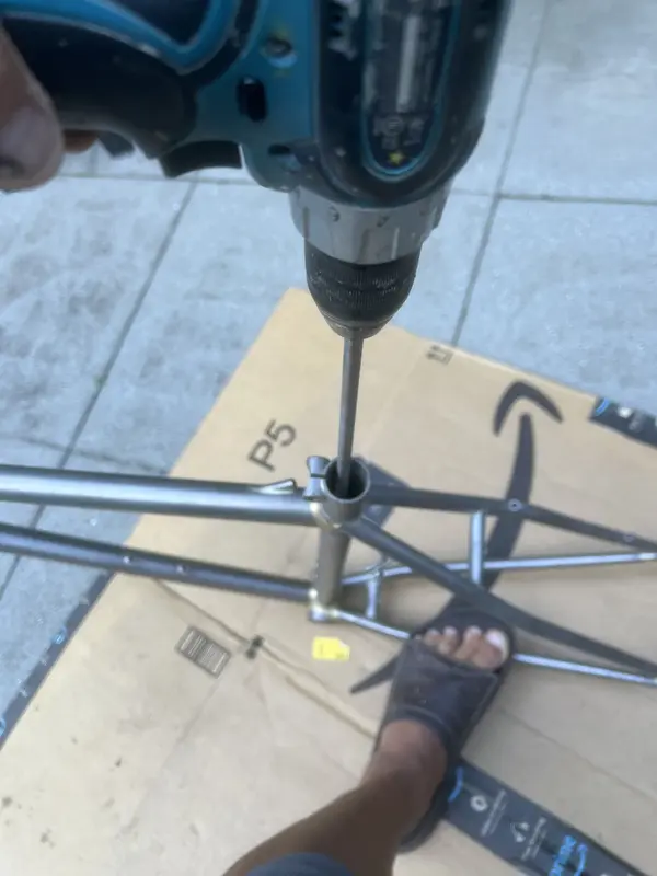

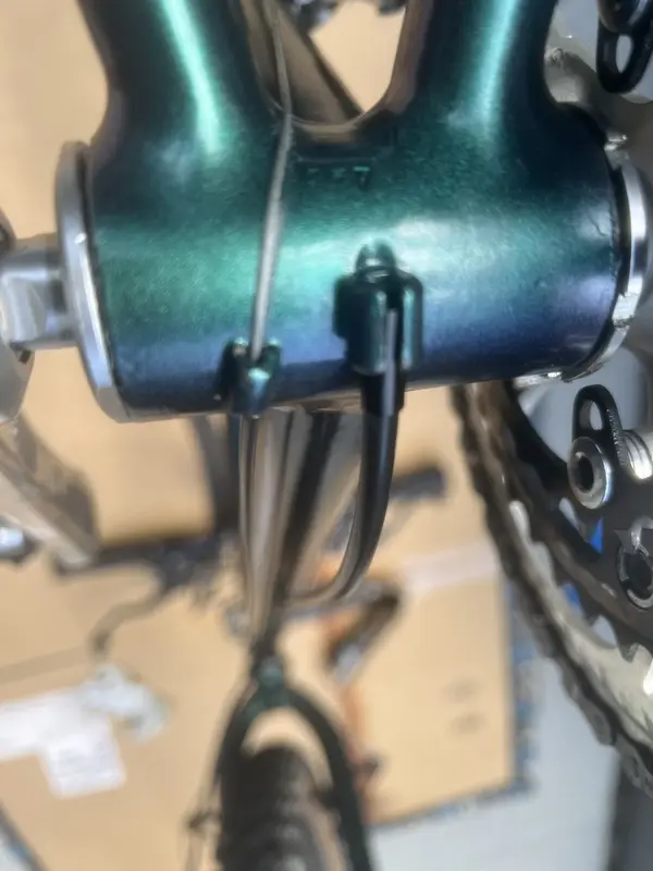

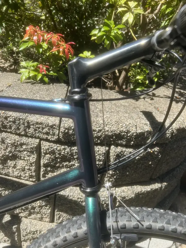

Painting:
Here are the frame and forks being primed and painted, with micro dents/scratches filled in.
Before painting the lower chainstays / internal cable tubes were filled with Por15 Rust Remover for several days to eliminate any possible residual internal rust, with silicone used to seal it in.
We went with the original metallic green color scheme but added some subtle bling with a color changing paint that changes to metallic purple in the right light. ( There were no purple 3DV (purple anodized parts ) in 1987 so this had to do ). IMG_9436.webp IMG_9442.webp
