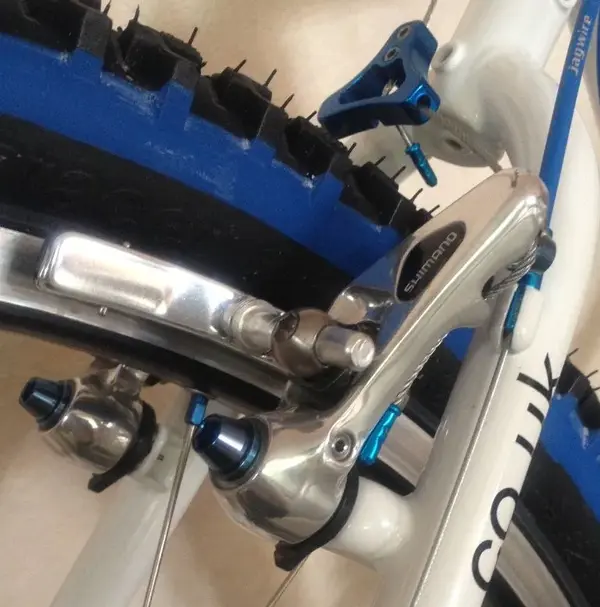

Firstly an example of the brakes:
Blue ti mounting bolts, Blue ti washers, Blue ti cable clamp bolt & Ti pad holders and ti nut.

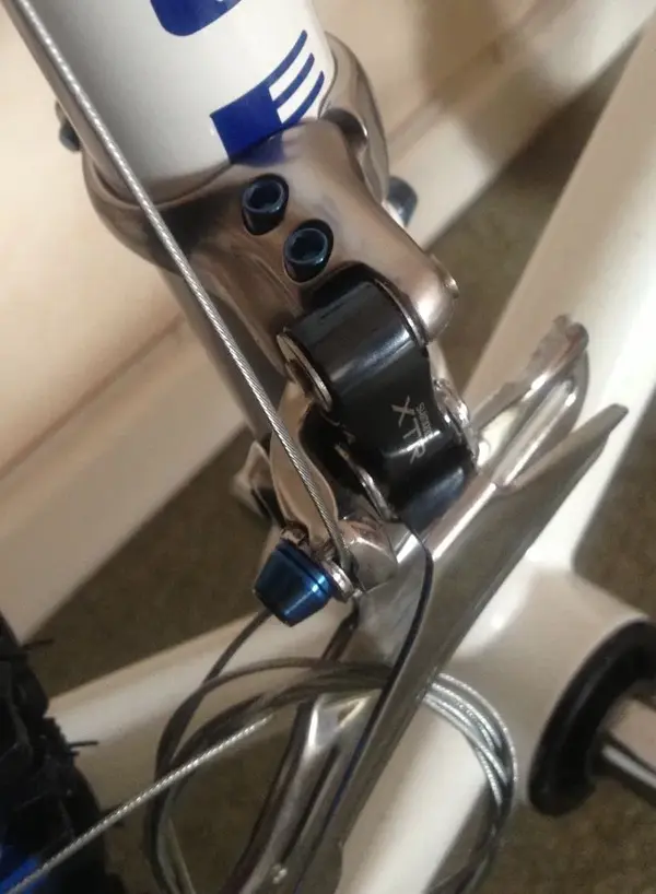

The M901 front mech:
Blue ti clamp bolt, Blue ti cable clamp bolt & Blue ti adjustment screws

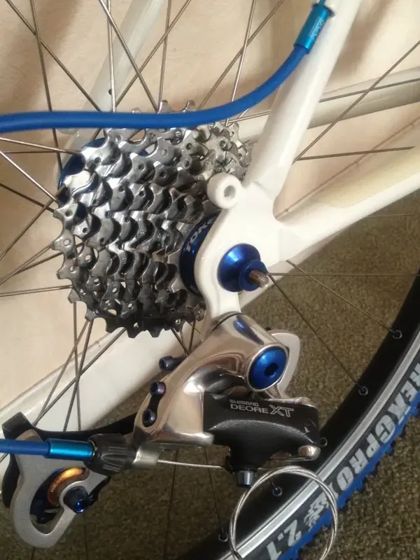

The M739 rear mech:
Blue ti cable clamp bolt, Blue ti Jockey bolts, Blue ti Adjustment screws, blue Alu hanger bolt & Blue jockey wheels

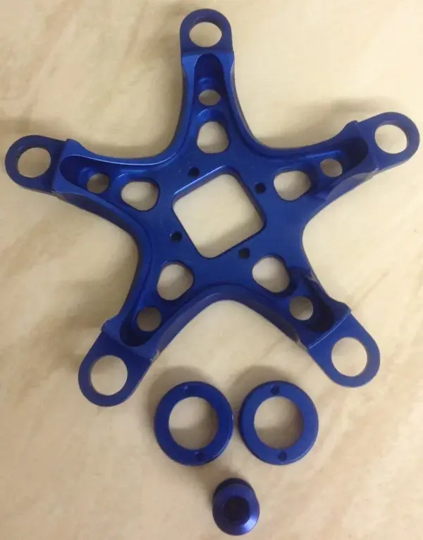

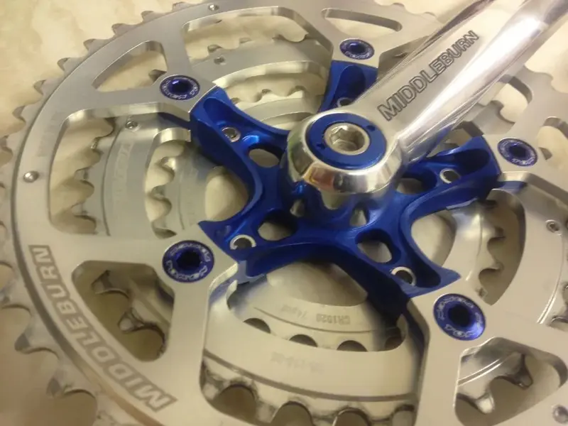

The final parts came together today when my middleburn Spider came back from re-anodising by Steve Barry of Bracknell, Berkshire.
He did a superb job with it, I also got him to reanodise the self extracting crank caps the same colour. See the pics below: (the chainring bolt I sent as a guide for the colour I was after).
See before
And After
And assembled
