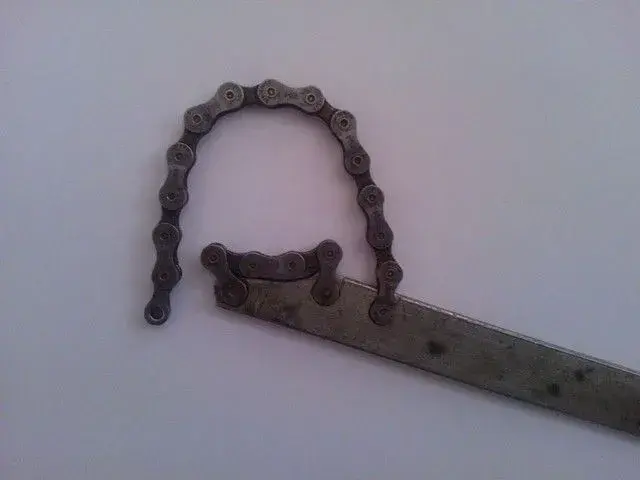

That is the strangest chain whip I have ever seen, and can't see why another tool is necessary.
Originally this was a 5 speed cyclo chain whip with an exceptionally long good handle, but I modified
the design and upgraded it to 9 speed.
Looks nice and strong- my problem (as well as being arrow dyslexic apparently) was that the first chain whip I used had a bb tool at the other end and was made of cheese: wasn't strong enough for purpose. The one I've just bought (technically for plumbers not bikers) cost less and is stronger. Needs a tiny bit of modifying to be perfect but will do that later...
I bought the clamps (oil filter remover) to modify into the cassette tool like park have, where it basically vice grips on a chain- might be better for me but needs work first. Its another option to throw at the wall and swear at if things aren't working out.
