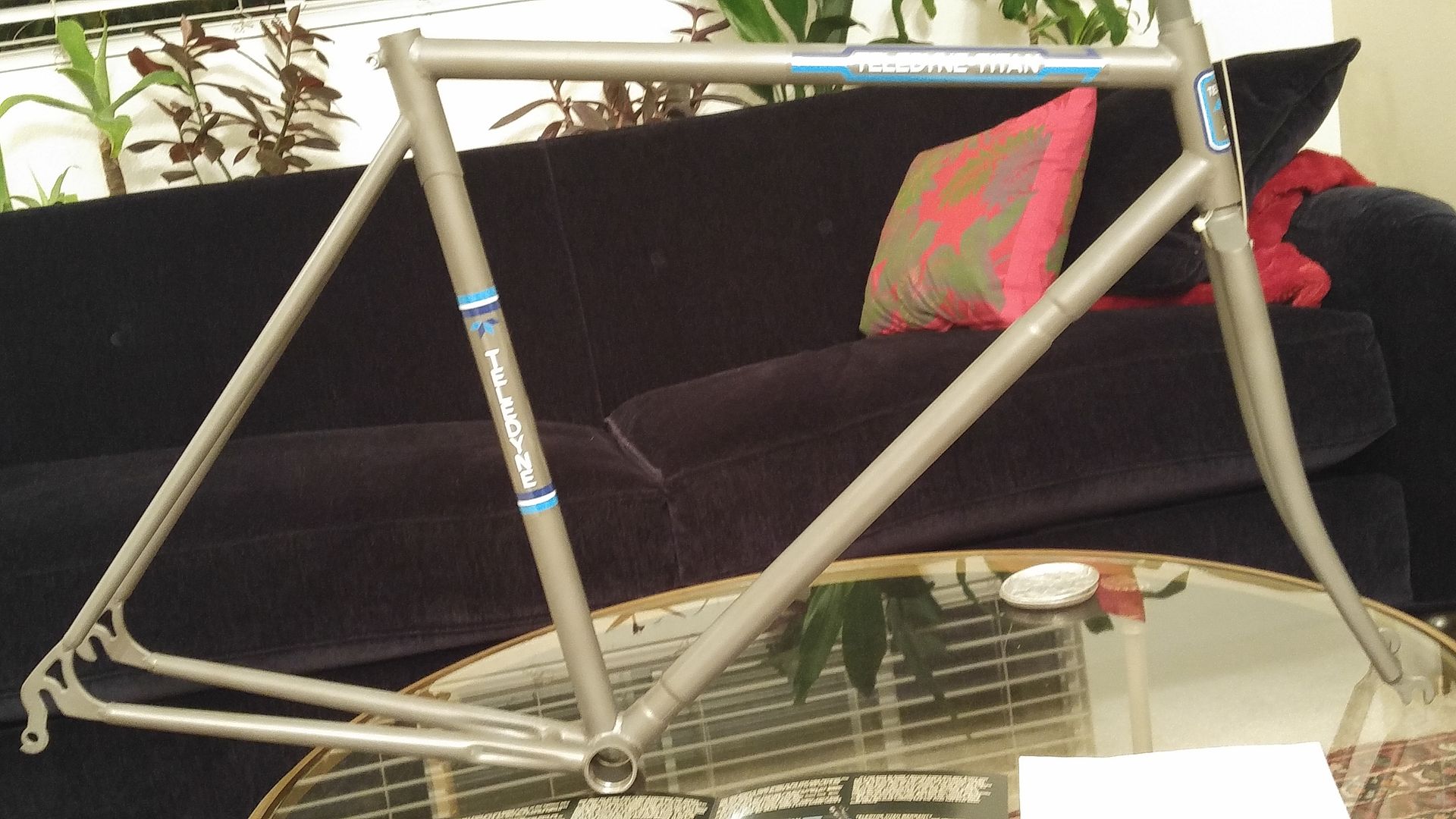

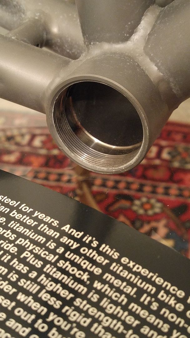

Some deals are better than others... The First titan frame was a bit of a pig with a crushed rear brake stay and late serial number replacement Titan fork with to long a steer tube, lets say it had a hard life. This wasn't a frame I wanted to build, though I did get it for a good price. I decided to cut my losses and start a search for another Titan frame. I'm keeping the first frame to use as repair pieces should I need them in the future.
With some luck I was able to locate a new old stock 22 inch Titan frame (a better fit for me than the 21 inch first frame), I bit the bullet and bought it... Lets face it, we don't build classic bikes to make money, we build them because the bike speaks to us.
I received the brand new 1974 Titan about four hours ago, now to wake it up after its 42 year long sleep!!!
I even like the box.
WOOT!!!
Details...
More...
I like this...
My spare fork even fits :shock:
More fun to follow, tomorrow some parts photos.

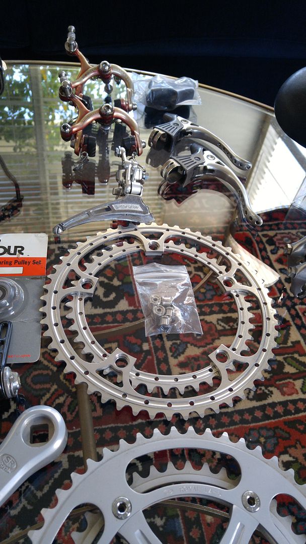

Thanks for the kind words :D , I will do my best to keep it interesting. This is some of the kit I have collected so far, Sakae Ringyo (SR) ESL seat post (dated 76.8, 244 grams) and 110mm ESL stem (210 grams), ESL was there top of the line Extra Super Light parts group from the 70's, basically Royal parts with milling and titanium fasteners, the crankset is a standard NOS Sakae Royal with bottom bracket getting retrofitted with Cambio Rino chain rings (118 grams for both rings 42-52) and titanium hardware to bring it up to almost ESL spec, I am still looking for a titanium spindle (the Royal group existed in 1975, I'm not sure of the first year it was introduced).

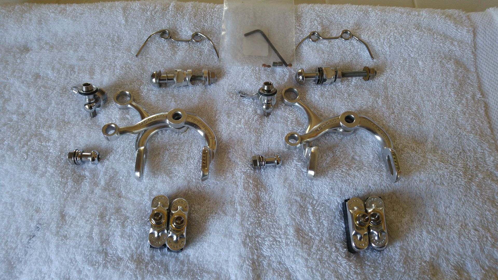

Brakes and levers are Modolo Professional 1977 (Brake set with levers, shoes, and hoods, 570 grams) and are due to be stripped of anodizing and polished.
Hubs are Weyless from 1976 and weigh in at 421 grams complete with skewers :shock: .
Front and rear mechs weigh 268 grams for the pair and are first edition Suntour Cyclone's with late 1974 date codes, the rear mech is getting updated with suntour sealed bearing pulleys, downtube band on shifters are Suntour Cyclone from the same era and weigh in at 63 grams, Suntour 14-23 Pro-Compe 6 speed ultra spaced freewheel weighs in at 421 grams, 1977 date code.
Pedals are NJS stamped Keirin track MKS Custom Nuevo (that are a freak of nature as they have titanium spindles that I have never seen on a early 1980's Keirin pedal), with ALE alloy clips and toe straps weigh in at 340 grams for the set, date code who cares they're cool.

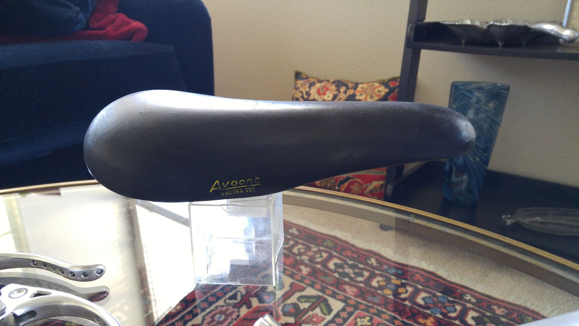

The saddle is a 1977 ish Avocet Racing III with alloy rails and weighs in at 281 grams.

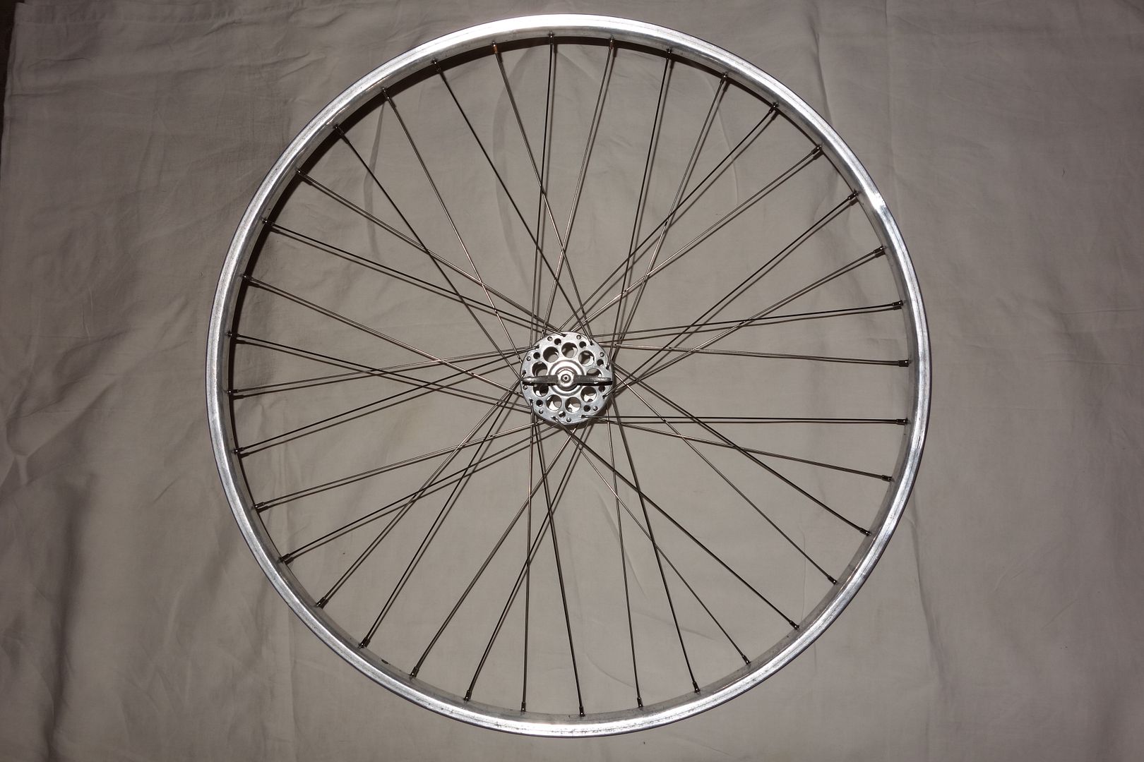

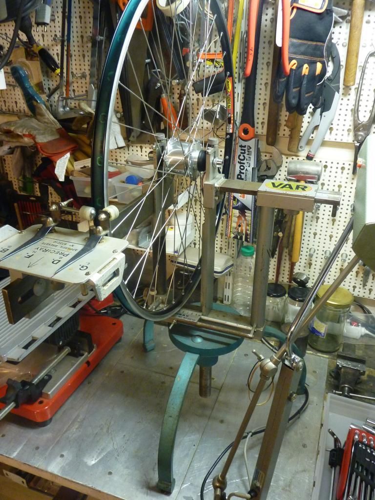

About wheelbuilding, I believe one's tend to overestimate the skill into it.
Thanks to Sheldon and a good truing stand , it becomes just a job of patience , good sense and replication ( I tend to have a proper built wheel to "copy it" when I do)
Also I was very lucky to get my hands on the "pro tool" truing stand of the 70's - the Preciray - in a very large stash of VAR pro tools from an old amateur ( just missing the bottom bracket BSC tap as mine are only french ! :roll: )
as you want pic - just finished that for a high end french city bike from the 50's :wink:
FB hub with Mavic old rim and new DT revolution spokes

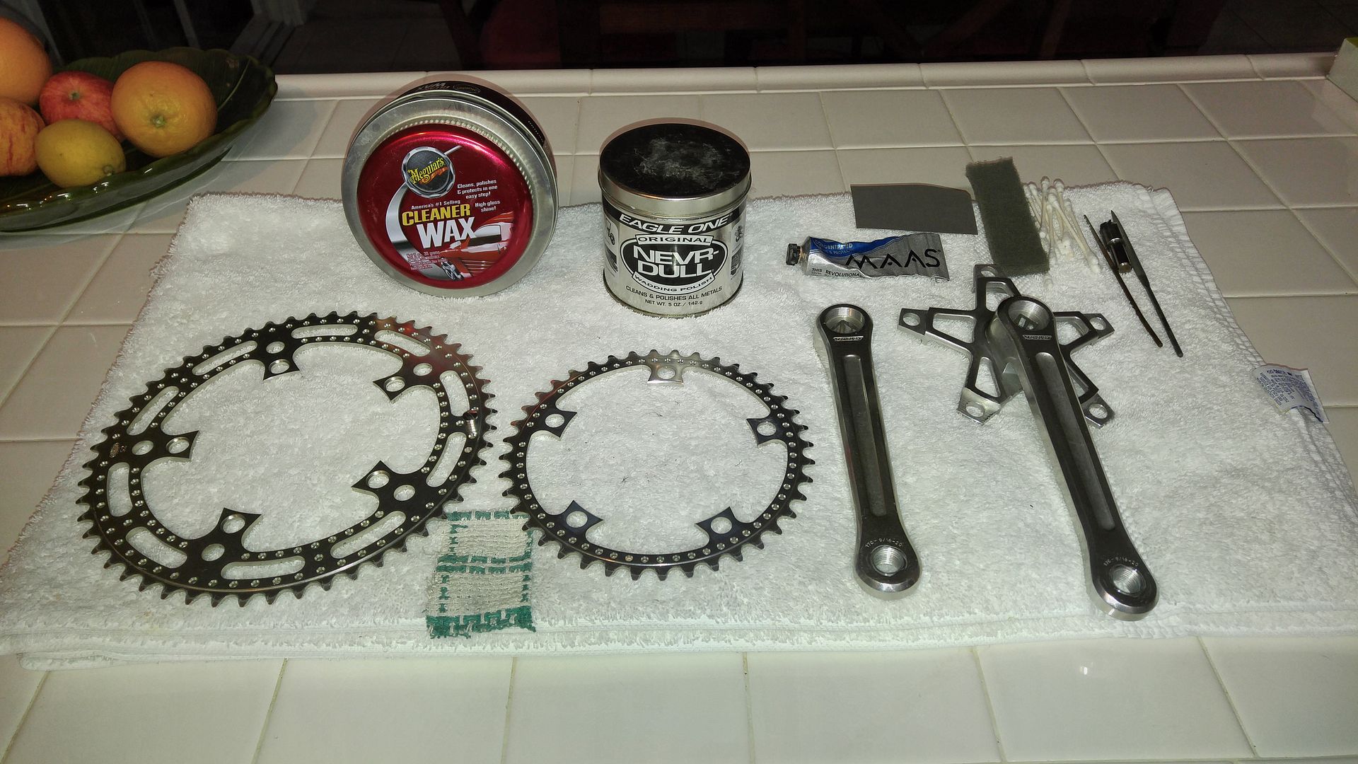

A change of mind... It's been awhile since I have updated the Titan Project. Back a few months ago, I mocked the bike up on the floor and what I saw didn't match my vision, it was all good kit but the total package wasn't doing it for me, Time for a new plan, so here's where we are at today.
Huret Jubilee, Stronglight 105 BIS + 651 bottom bracket, Simplex Retrofriction, Zeus 2000 Alloy, Modolo Professional, Campagnolo cable bits.
What's here is overhauled and ready to run.
Anodizing stripped ready for assembly, the best of 2 brakesets with some titanium bits.
Deburred, origional anodizing cleaned and polished
