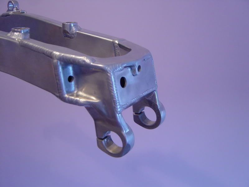

I "think" that front mech should be ok with a triple ring chainset, but I know that on some Proflex with the alloy swingarm you need to use a certain type of front mech or they can foul on the swingarm... bottom pull, top swing rings a bell...
Is it for your Black Proflex? does the cable come down to the front mech from the top?
Do a Search on here and you should find a few useful threads, I remember the question being asked before.
A Beast with alloy swingarm and front mech...
same swingarm design as yours?
Not the same arm on my black flex no, mine pivots behind the seat tube, thanks for the info, like you say think there must be a small selection of front mechs that work but maybe not this particular xt.... Will see what I can sort.....
i used a common old normal lx bottom pull on my 95 proflex....interesting to note that the subtly changed the angle of the seat tube on the '96 ones for better Fd operation/compatibility

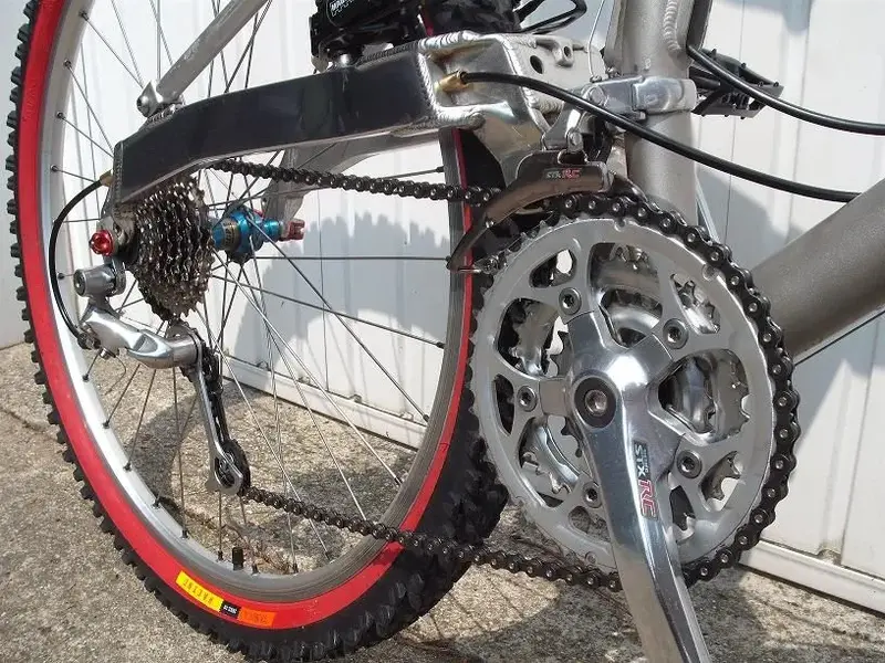

Hi, you might have to adjust the high/low screws on your front derailleur,they adjust for large and small chain ring selection. most High clamp bottom/dual pull front mechs will work with your Beast. I have a 96 656,which I think is similar to yours. I'm running Sram 9 gear on it .Cheers,Rob.
One STX-RC front mech, £10 NOS from evilbay, High mount, bottom pull, works a treat, mind you i have full STX-RC on my 856 but i also have a Beast and similar set-up / geometry. Can be a bit fiddly, top tip, replace the cable clamp with a Hex bolt saves the hassle of removing the rear wheel and inserting a long Hex/Allen key through the hole on the swing arm to tighten and slacken the cable.
