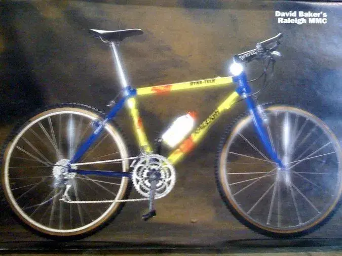

Had a dig around last night and found a few bits and bobs. I have found the full spec for David Bakers 1992 race bike which might help.
Spec
Frame and Fork- Raleigh Team Issue MMC
Bars- Raleigh prototype MMC (98g)
Stem- Syncros Cattleprod 140mm
Grips- Bar tape or ODI Tomac Attack
Bar ends- Onza Titanium
Wheels- Bontrager BCR-1, DT swiss DB spokes, White Ind front, M900 XTR Rear
Tyres- front, Specialized Hardpack 1.5. Rear, Panaracer Smoke Lite Comp
Ringle Ti Stix Skewers.
Seatpost- USE Titanium
saddle- Bontrager Ti rails
Brakes- Front M900 XTR canti and Sti
Rear, Dia Compe Lever, Weinmann Cyclocross Cantilever
Drivetrain-
Cook Bros racing Cranks, Campagnolo outer ring, Onza middle and inner 50/36/26
Cassette- 12-28, mixture of Dura Ace and XT
Chain- Dura Ace
Bottom Bracket- Syncros titanium
Pedals- Shimano SPD
Front and rear mechs- XTR M900
Shifters- Front, Deore XT M732
Rear, XTR M900
Bit of a mish mash.
Thumbie was used because he said he suffered from hand fatigue on longer races and he could use his whole hand to shift instead of thumbs.
Cassette was a lash up because the XTR's kept coming loose.
Rear brake set up was because the XTR was too powerfull and just locked all the time. the cyclocross set up was just enough to slow without slowing too much :lol:
Heres some pics. sorry for quality, I have no scanner at work so I used a camera phone. Flickr has decided to put them the wrong way round and won't let me rotate so I'll leave that to someone cleverer than me

Thats used to be on my bedroom wall!
Sadly, I didnt keep it when I moved out :(
Paul Hinton was, IMO, the 'cooler' Raleigh rider with all the flash kit :lol:
8)
Easier on the neck......
