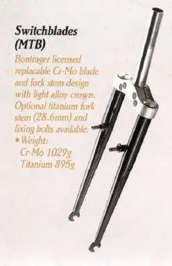

Were all switchblades made from prestige tubing? Any other info on them?
They where a licensed design from Bontrager and it just has a Cr-Mo blades, Alu crown and Cr-Mo or Ti steerer.
EDIT one min.
pic added.
Not lightest forks in the world Tange Struts, Ultralight and Big Fork where all lighter.

from a ahem BMX site, but someone who tested them BitD I guess
I believe the crown design was licenced from Bontrager but the legs are different to the original design, -the Bonty having bonded ends and machined and riveted brake mounts.

find the patent and you'll find what they licensed, maybe straight legs where part of the license... of course it would be a requirement of the design of the crown so possibly also part of the license. Designs don't need to be identical afaik. :D ...
or aka I have no idea, I just repeated what the brochure said ;)
EDIT found the, what I assume, is the patent... well there are only two by Keith ... which begs the question did PACE also license it and everyone else that had all three parts 'loose', or was it not relevant in the UK ?
The design is for a twin bolt fixing and quad, includes legs and steerer in the design...

...as far as I know... Yes, they were all Prestige.
I owned a Tangé Prestige Switchblade once. There was no 'link' to Bontrager back than... Mine had a different crown whitch made even more heavy. I believe mine was produced in 1989. In the pic you see what I mean.
and that style crown and fork setup is what is outlined in the patent and also as used on the RS1, so if anything that is the Keith Bontrager design and the one in the picture I posted is a modified design.

FluffyChicken":p3izlxby said:
Agreed -this design was almost certainly Bonties famous contribution.
FluffyChicken":31kt3y4q said:
...that is the Keith Bontrager design and the one in the picture I posted is a modified design.
Ah.. didn't know that. I knew Bontrager made or designed some, but I thought that Tange made their own with the heavy crown. I thought Bontrager made/designed the lighter ones.. and than collaborated with Tangé to have 'm made later on...
thanks for the info
