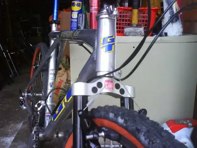

I have a 1/18th on my GT.
They're treaded but long enough for use with Ahead.
NOS from Sithlord.

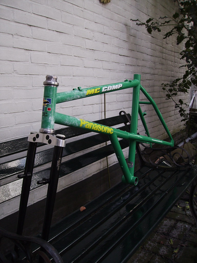

No need to machine reducer cups, they are available in the marketplace. Try a decent internetshop or a serious lbs. Works perfect.
See =>
