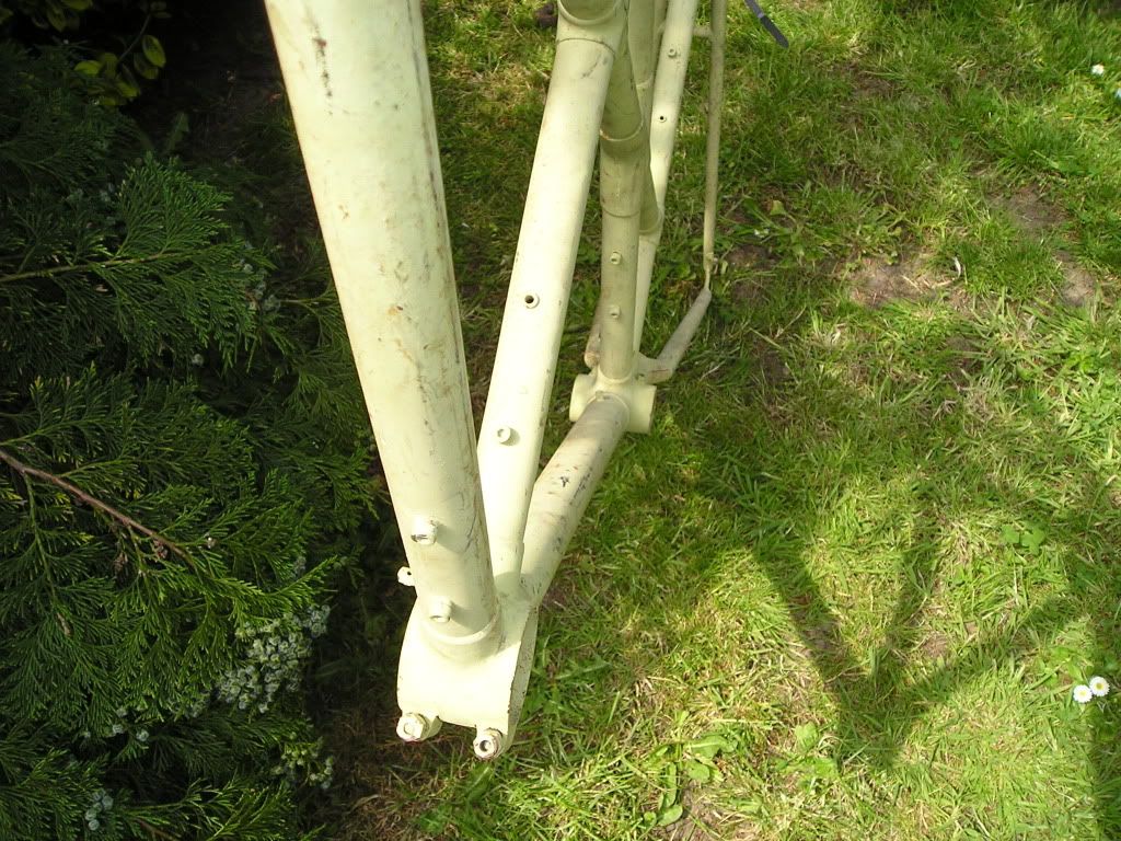

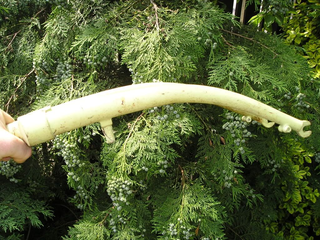

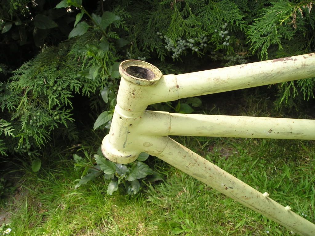

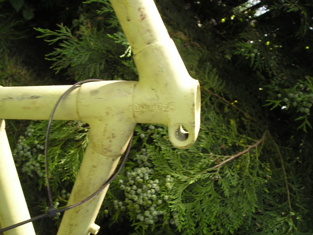

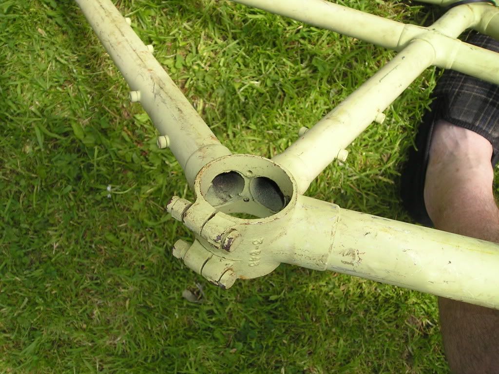

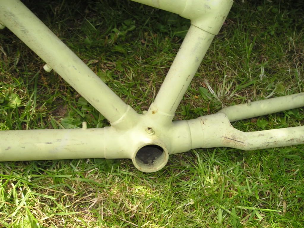

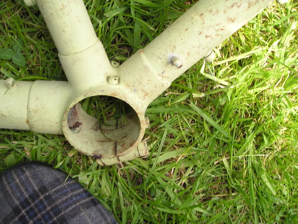

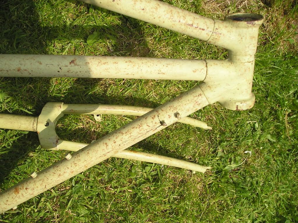

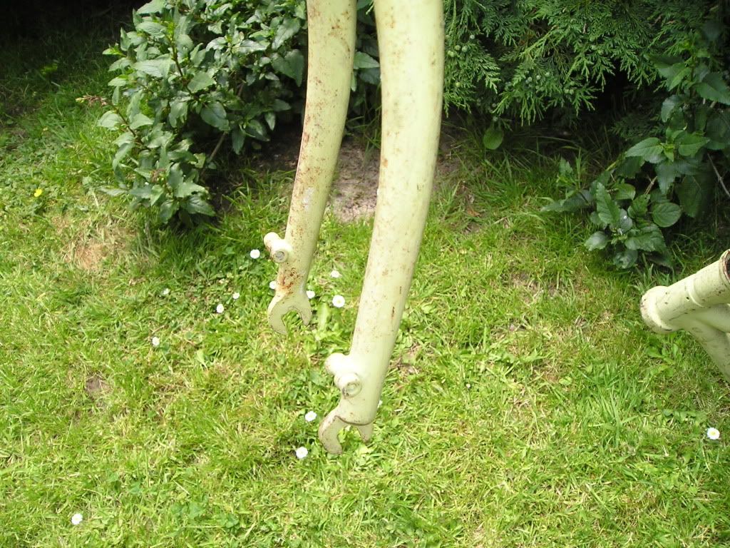

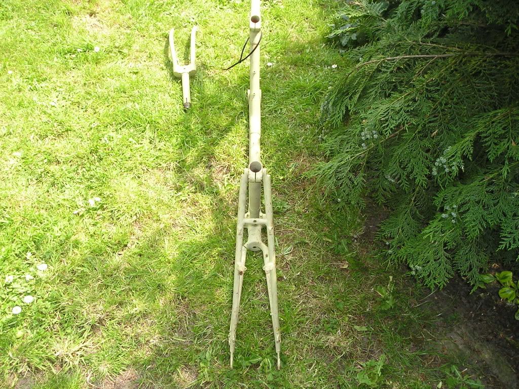

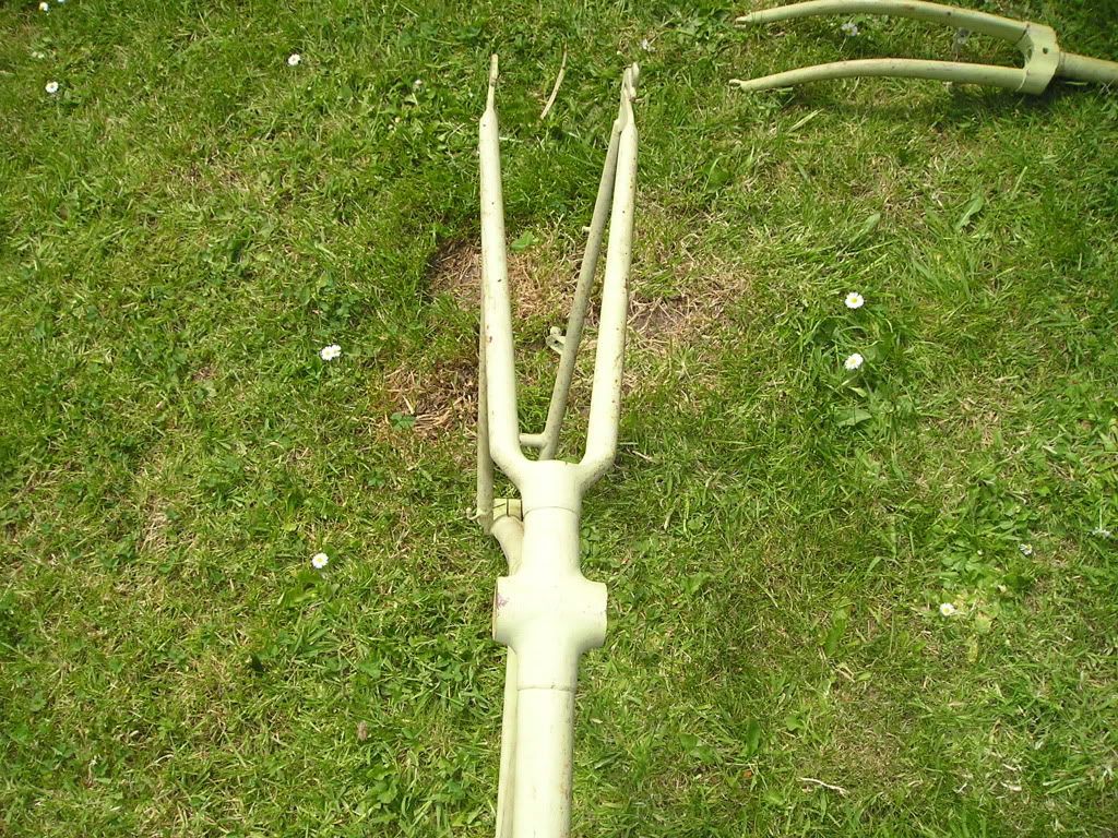

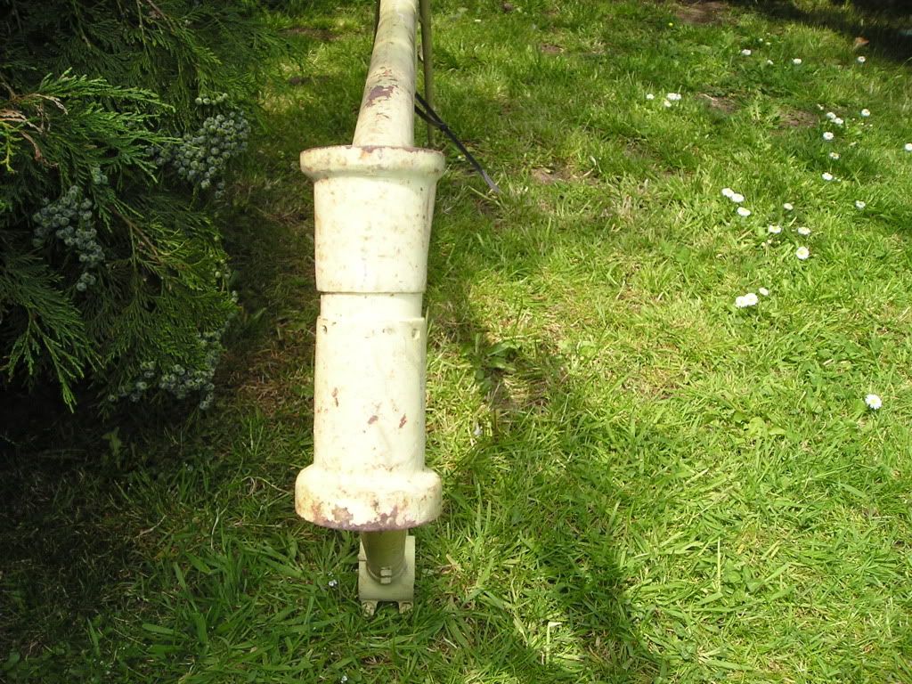

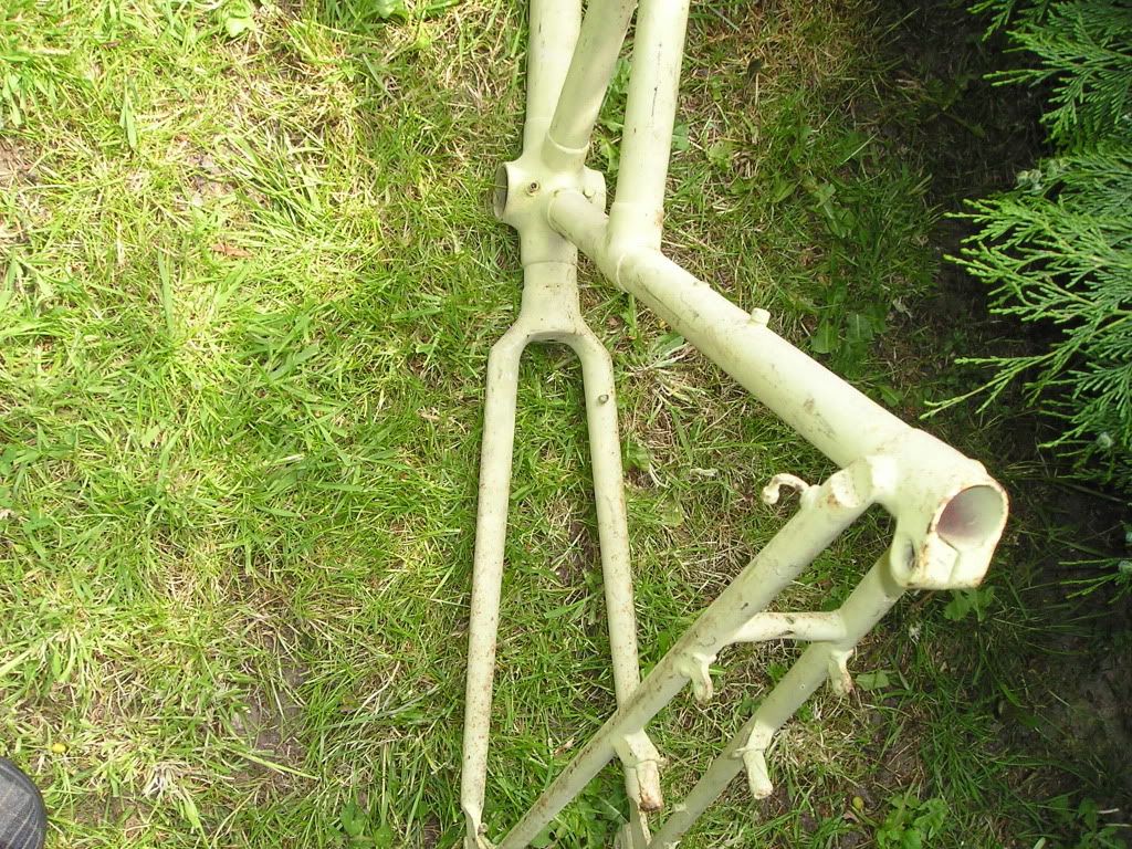

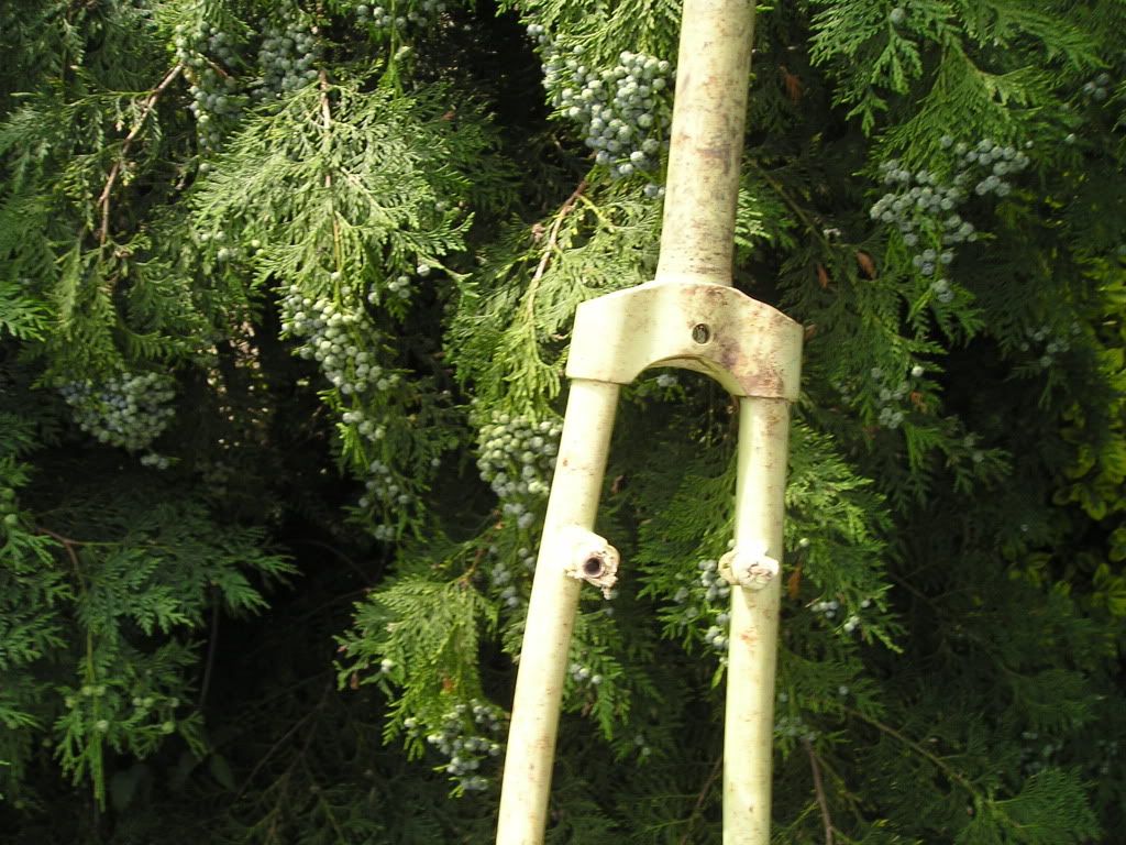

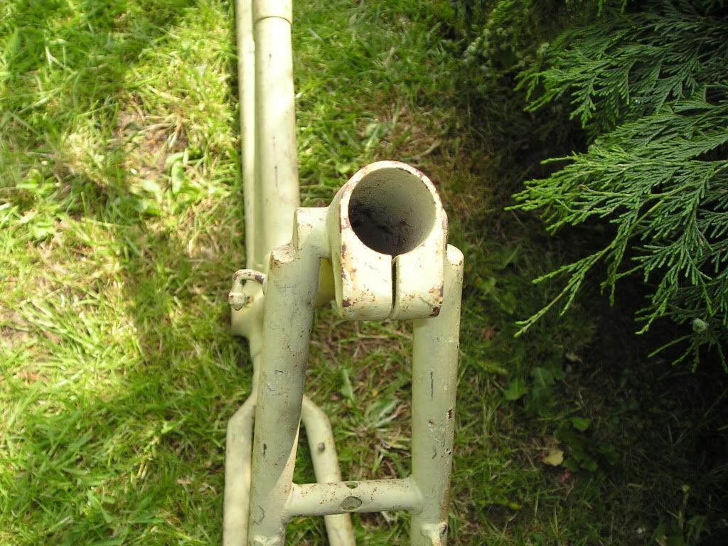

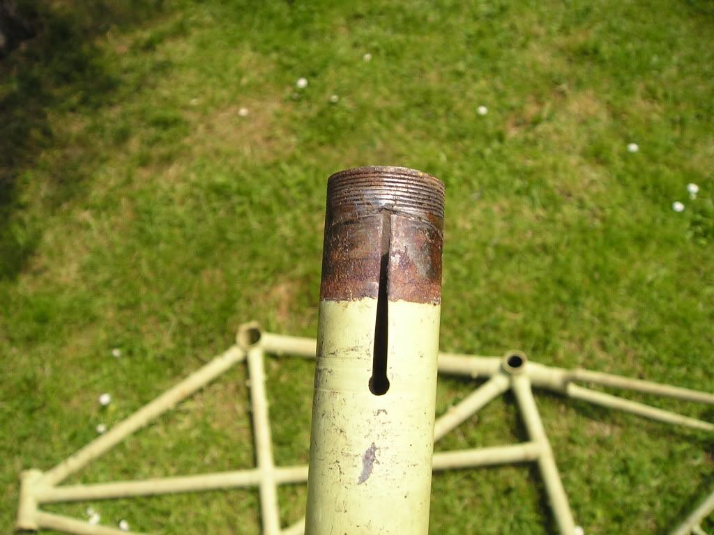

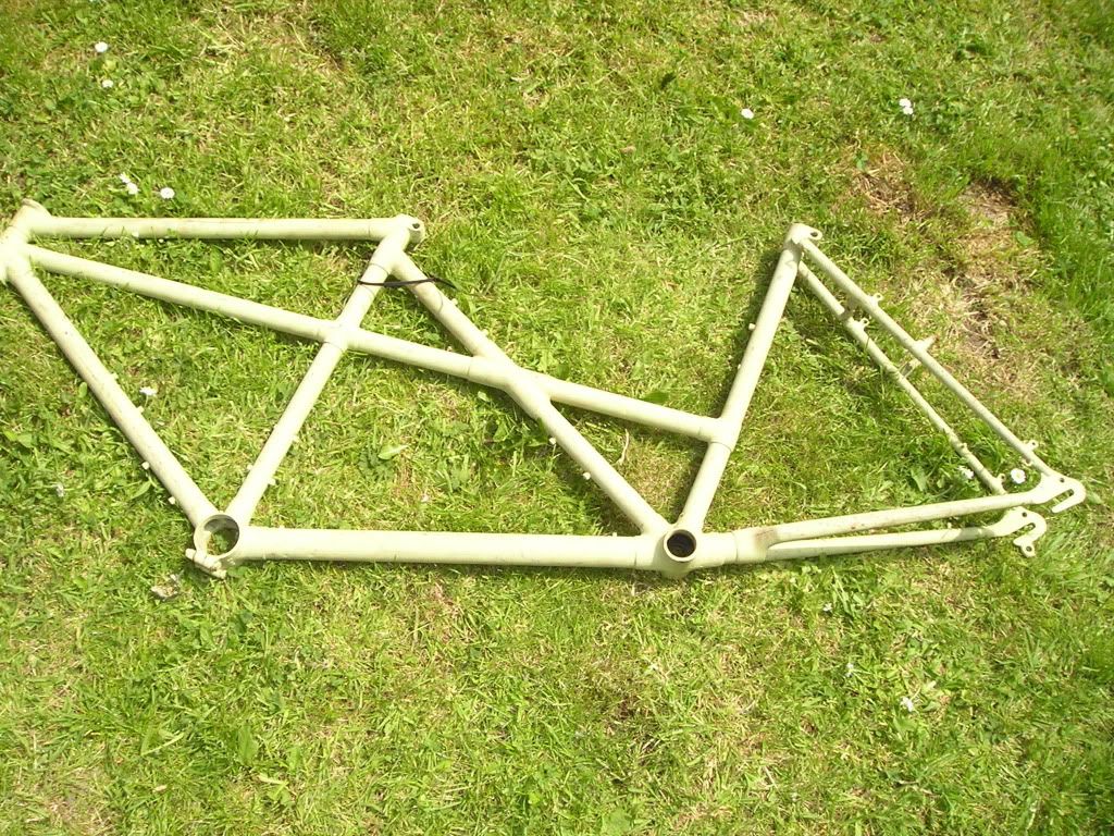

Here are some pictures. You'll have to forgive me for my over enthusiastic camera work. :lol:
I received it from a very nice guy a few weeks ago, who said he might have a few bits knocking about.
Basically, I have the frame and the forks.
The frame and forks are steel. The guy said it could be 531 but I think it seems too heavy, though what do I know.
Frame weighs: 7.2kg
Forks weigh: 1.7kg
Weighed on my bathroom scales so probably not accurate. :lol:
It has a few markings, although the headbadge has unfortunately been removed, unless it is new.
On the large bottom bracket floor, it has the markings 3 - 643.
On the top of the male seat tube, it has D0 1095
It really needs a sand blast and decent paint job, something I don't have funds for at the minute.
The forks seem to have a strange split just before the thread. It looks symetrical, so might be deliberate.
That's all I can really tell you at the moment. Any info would be cool.

The fork's been modified -- originally this would have had a "headclip" headset, with bearings that sit in the flared ends of the head tube and a clip that slides onto the steerer and tightens with a pinch bolt, a bit like a seatclamp collar. It also holds the stem in place -- the stem wouldn't have had an expander wedge, just a shaft that goes inside the steerer. Looks like someone's welded a bit of threaded steerer on the top to use a locknut from a more modern headset.
You're going to have fun putting it back together -- it's a 40s-era frame and fork, almost nothing modern is going to fit :/

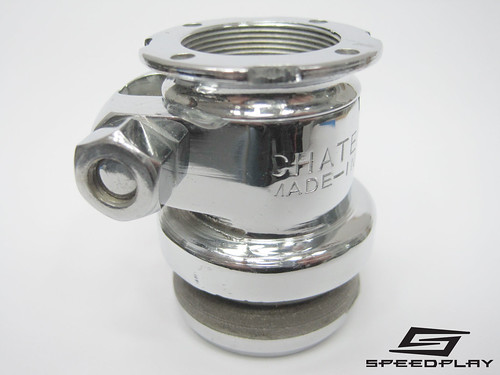

I've changed my mind about the fork, I reckon it's meant to be like that -- what I thought was a joint is actually another slit for the headclip bit to clamp the stem, turns out that headclip headsets do indeed have a threaded locknut on top:
Chater Lea - Headclip Type by Speedplay Museum, on Flickr
Hard to come by nowadays, although some old tandems used 1-1/8in steerer tubes, and it's possible (unlikely, but you never know) that you might find some headset bearings out of a modern headset that'll fit in the frame satisfactorily -- it's not unlike a modern integrated setup. Might need a different fork if you go that route, but that won't be hard.
If you can sort the headset the other idiosyncracies shouldn't be too challenging. The brake bosses are probably positioned with 27in wheels in mind, but brakes with enough adjustment might be able to accommodate 700c rims, they're not hugely different. The rear dropout spacing is probably something not very useful, but you can almost certainly "cold set"* the back end to a wider spacing to fit readily-available hubs.
* OK, bend :)
