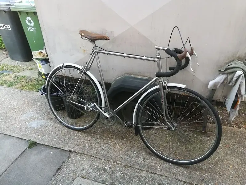

Just tried what I have lying around which was a 42t chainring and 19t sprocket attached to the £2 carboot sale wheel that set me on this path of madness.
<note to self: must not 'stop' pedaling...>
Looks good but I would wear shin pads if you intend using those pedals. with clip in pedals you just get a reminder nudge if you stop pedaling, at first your reflexes may not twig what is happening so beware. Perhaps with flat pedals you may actually learn quicker than the shin scars take to heal.
