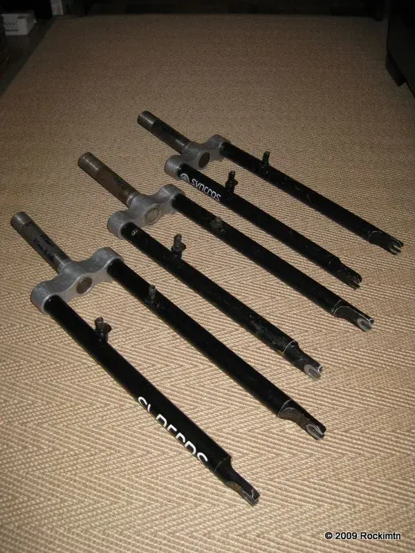

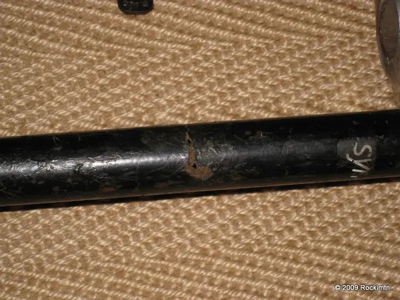

only prob is i have a few issues. one 1 1/8" steerer is very short, other 1 1/8" has rusted through legs with okay length steerer but some of the threads are damaged, and the other steerer is 1" which i don't need, and steerer is the shortest.
thinking maybe of swapping the good legs (although i do hear a bit of rust rattle) off the 1" and put it on the longest 1 1/8" steerer with the bad legs.
any advice on how to check the integrity of the legs? should i pop off the top caps and spray the insides with something? has anyone ever repaired rusted out legs before? and is it possible to swap out the steerer?
as well, how do i go about restoring the finish on them? i am considering refinishing my Blizzard in white and have one of the powerlite forks done with the same finish. are they painted or powder coated?

No sure how available a dip tank is to you but I would remove the legs and have them dip stripped. That will remove all the stickers, paint, powdercoating and rust. That way you can truly get an idea as to how bad the rust really is.
As for swapping out steer tubes? I don't know how to do it but it has been done.
If you're going to paint or powdercoat, be prepared to sand down some of the finish to fit the legs in if you opt to have them finished while off the crown. Powder will be thicker than paint but even paint will make it difficult to slip them back in without sanding. A "good" painter will be able to mask the crown so you can't see a seam.

just get the steerer extended on the good set, problem over.
As for the other goodies on your list, I have them all but sadly need them :wink:
i briefly looked at steerer extenders and converters in the past.
extending a threadless steerer is a no brainer. and i'm aware of ones you use to add on to threaded steerer to be able to use a threadless stem, but the HS still has to be threaded?
is there one to extend threaded steerer and retain threading?
