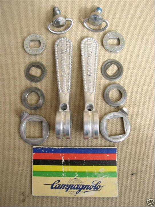

You may find that all you need is 1x pair 600/2 & 611/2 backplates/stops like the square-centred ones at the bottom of this pic from Velobase:
Nigel at Campyoldy sells them for a whopping £2.40 a pair.
You're right in thinking that the equivalent part on the band of some earlier shifter pairs is non-detachable. In some cases, the thicker washers/collars shown above the backplates can also be integral to the band assembly. If that's the case with yours then Nigel also has the parts you need: #661 Brazed Boss Collar at £4.50/pr. He only has the more recent plastic ones and not steel as pictured, but once assembled you'll never know.
I know all this as I've recently covered the same questions with Nigel while trying to complete a set of braze-on gear levers!
Also, to be period correct you should have lever blades with the raised logos as pictured here and not the stamped ones from a later period. If you have the later stamped lever blades, then I would consider swapping the earlier pair that I have, if you're interested.
