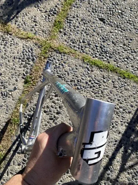

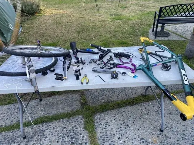

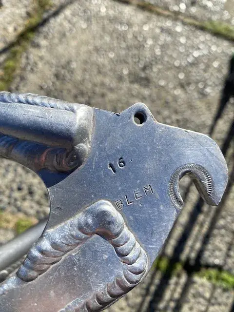

I started removing hardware from the frame to strip the decals and found “BLEM” stamped in the dropout.
Presumably it’s a BLEM because the GT logo is upside down on the headtube. Everything else looks to be in reasonably good condition. Above all, she has zero cracks.
I stripped the decals with aircraft remover this morning. Hours of wet-sanding and wire wool await. Being a California native in the dead of winter, wet sanding in the freezing 65 degree F afternoon sun will be arduous and barely tolerable. No, seriously, that’s friggin‘ cold for us.
Being that the donor bike is 100% complete, I only intend to replace a few components.

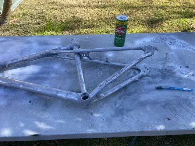

scrubbed the welds and nooks with abrasive bathroom cleaner and the wife’s toothbrush so primer will bond without fish-eyes

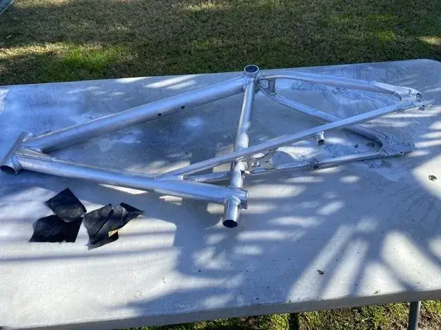

Wet sanded with 600 grit to knock down protruding scratches and identify which areas need filler.
Dents & scratches have been filled with JB Weld (best body filler ever) and sanded smooth. I gotta figure out how to hang the frame and spray on a layer of etching primer folowed by sandable primer…

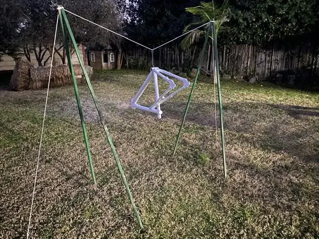

I made a makeshift frame hanger out of miscellaneous stuff from the garage to primer the frame. I sit watching paint (primer) dry. Years ago I block sanded my car to prep for new paint. It had a layer of etching primer followed by 2 coats of [other] primer. I followed the same premise here in order to assure a durable finish.

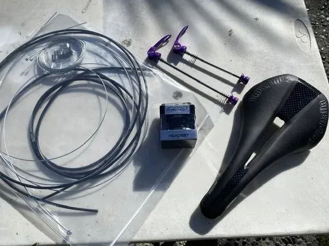

And in a moment of weakness, Answer riser bars, Easton stem, Origin8 purple headset and a Teflon cable guide persuaded ol’ Sup to hit the BIN button.

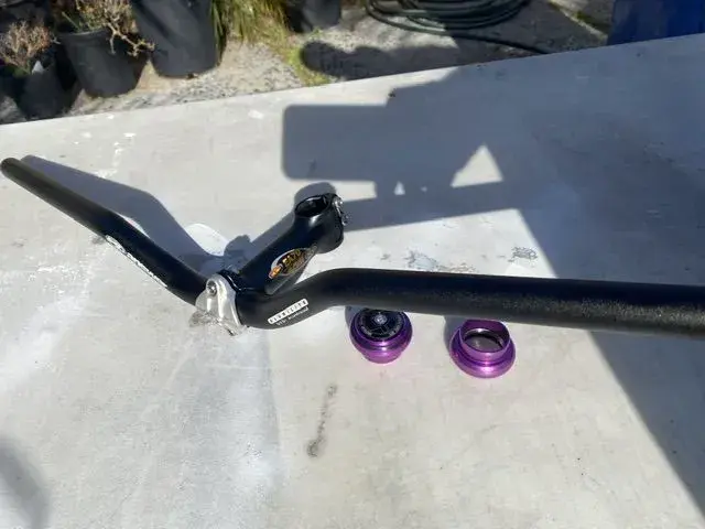

More parts arrived. Taller handlebars and shorter stem because I’m aging like milk rather than cheese.

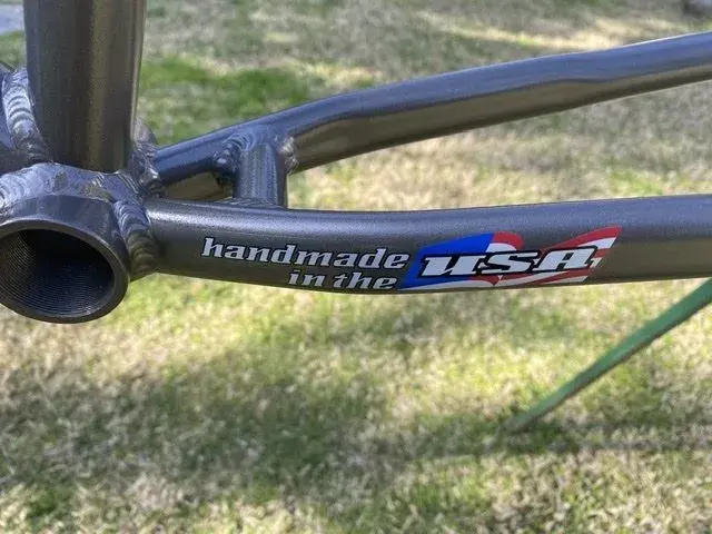

And a decal that represents this bike, being a mix of XT, LX, GT, Thomson, Easton, Manitou, Answer, Selle, Cane Creek, Pauls, Tektro, Araya, Michellin, Origin8, Wellgo, Kalloy….maybe more.
Paint is drying, decals and clear coat are at the ready

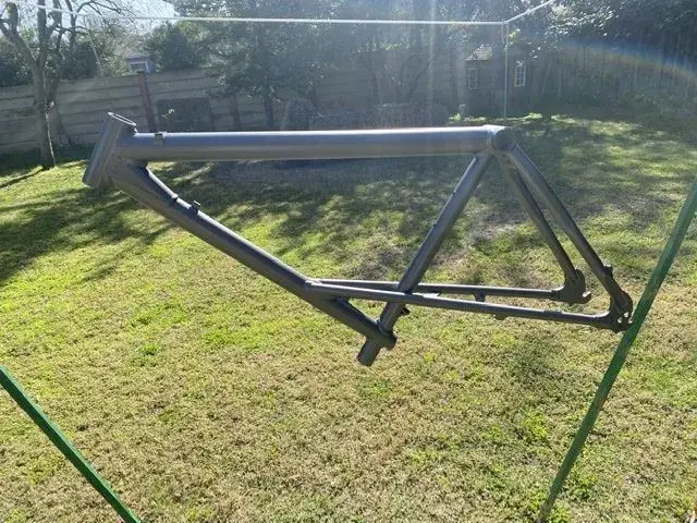

Primer was wet sanded to be a few microns thin (minimal soft primer beneath paint provides a rugged finish) and gunmetal grey was laid down
