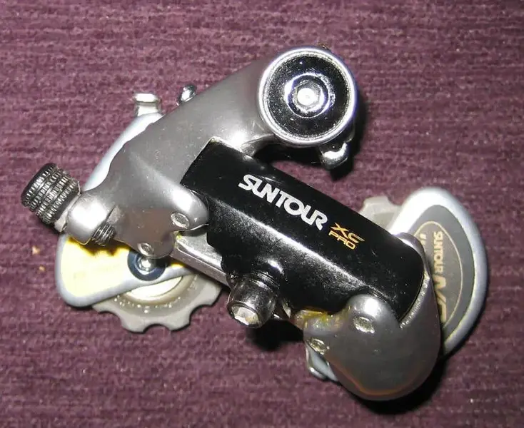

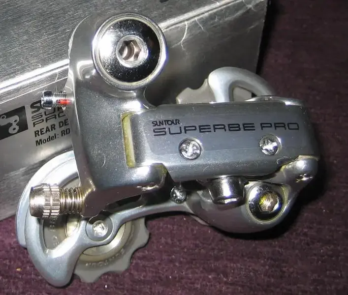

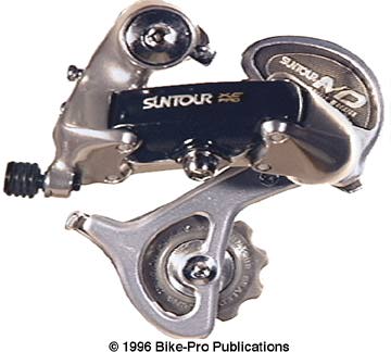

Both XC Pro and XC Pro Micro Drive, as well as XC Comp and XC Expert, are nice groups, and they fetch some good prices on eBay, so get your cash handy... 8) Avoid lesser groups like XCE, and the horride Express shifters. Superbe Pro was a phenomenal road group also. The Command Shifters are a work of art. 8)
