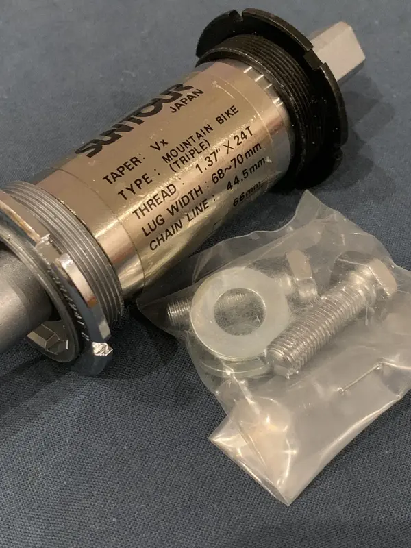

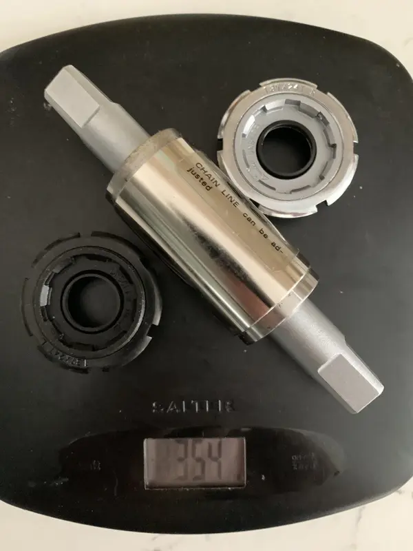

Not sure which version it is as there's nothing printed on the label but I'm guessing it's either a DS-220 or DS-230. I had thought the spindle length or weight might have helped the identification, but I couldn't see a relationship.

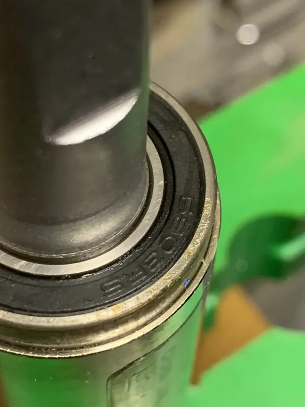

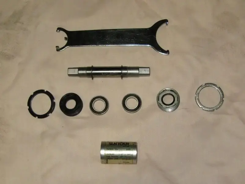

Construction wise, the unit is pretty robust. It uses two 6903RS bearing which are only £3.47ea and as you can see they're just pressed into the sleeve.
Why Suntour stopped producing these is anyone's guess but I can't believe the performance/longevity is better with a cup and cone.

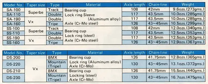

Okay, so what's the difference between a Vx and Superbe taper? I'm assuming that they're JIS variants but could do with some confirmation. Screenshot 2022-10-10 at 10.47.04.png
The table doesn't help the identification, as mine has steel bearing cups and lockings (DS-230) but it's 18grm lighter than the DS-220 which uses aluminium.
No idea, assumption is Vx is just JIS
