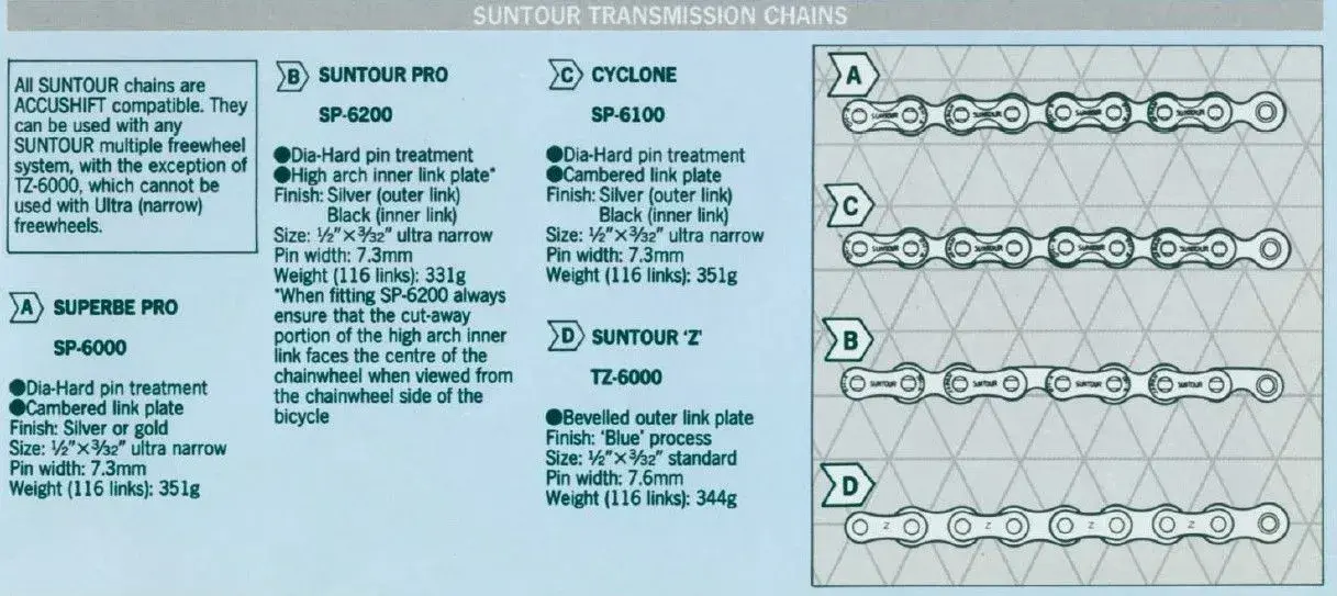

Suntour Superbe Pro (SP-6000) chain - SORTED
Thank you, an SP-6200 is my "Plan B" if I can't find an SP-6000 as I've no doubt that there would be no noticeable difference in performance but they don't seem to come up often (or at all!) on eBay
Re: Re:
Currently I am gathering Suntour SL groupset. Do you know if Suntour accushift shifters, rear mech will work soundly with Shimano hyperglide cog?
thanks
Not 100% certain but I'd check the sprocket spacing as you may find they're different. Presumably you're running a Shimano 7S hub as well?
