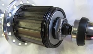

Ok, thanks, I wasn't sure whether I'd need a tool like this to remove the entire freewheel:
for hubs of this type :
But from what you are saying I have a hub with freewheel + removable cassette.
To unscrew the last cog, one has to turn counter clockwise, correct? :?

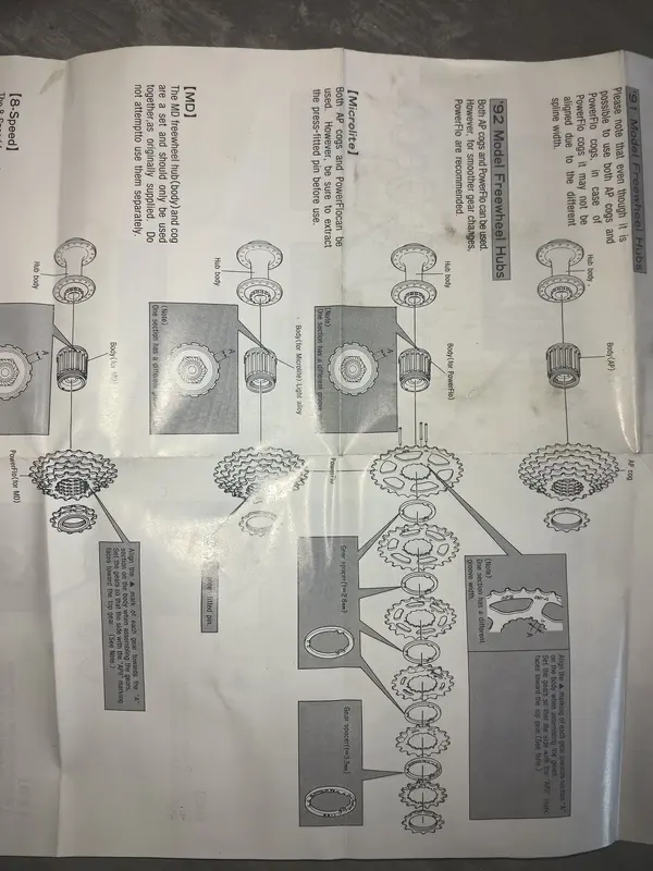

Hi - Could you possibly help with a similar question for a Suntour GPX?
The '89 catalogue shows only 1 - 126mm OLD, I have a 7 speed hub in poor condition and found a 6 speed hub at 126mm - would the spline length be the same for the two - I read the 7th cog was attached to the 6th - and would there be an adjustment required to use the 6-speed - or is the spline different lengths as with the posher version?
Is it possible to use the 6 speed or only a 7 speed - or (forgive the ignorant question) would it be possible to remove the spline from the tatty seven speed and put it on the new 6 speed hub?
