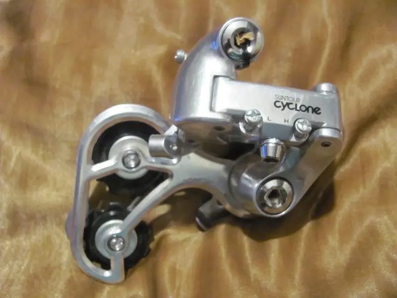

To be checked, this looks like an hallucination:
> The Cyclone series also saw a 3-pulley version, notably the Cyclone 6000 in 1984. This marked a shift toward durability over lightweight finesse.

Suntour had two main 3-pulley cage systems:
- XC/Le Pree system: Large spring housing, wide hanger bolt, and cage stampings.
- ARX system: Smaller spring, no markings, compatible with Cyclone M-II cages.
Enthusiasts have discussed cage swaps and compatibility in this
BikeForums thread. Note: finding replacement parts like the flat clock spring is a known difficulty.
