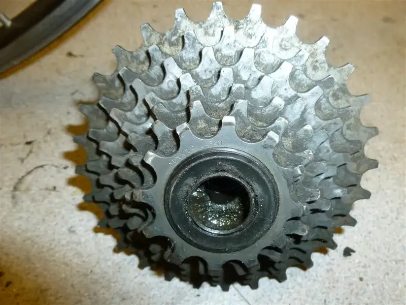

I have a Suntour hub on a Ritchey Vantage rim. The hub has the markings 'SUNTOU GI' and the cassetts is non ...glide???? Anyone know what these are?
The freehub is bolted to the hub but you remove the allen bolt via the non drive side of the hub - so the bolt goes all the way throught the hub. See the long bolt in the pics.
The freehub / hub splines are not shimano compatable???
The freehub cassette splines do not seem to be shimano compatable???
Can anyone tell me how to remove the cassette from the freehub?
Can anyone tell me if I can get a shimano 7 speed cassette on to this hub in any way???

You need to unscrew the top (smallest) cog, the cassette will then come off the freehub body.
You might find this operation easier with the whole thing fitted back onto the wheel. I fear that using two chainwhips as it is will cause the thing to fly in your face and remove a chunk of flesh if you are unlucky... :shock:
Says he who ripped a hole in his knuckles removing a stuck Shimano cassette yesterday evening... :oops:
Correct
Correct, though you cannot see them as the cassette is still on the body
Last cog is screwed on, so use a screw on method. (two chain whips, can be quite hard to get the little buggers off)
You cannot. What's wrong with the Suntour one.

technically you can fit a PowerFlo freehub body and its cassette and they'll shift almost as good. But the spacing is different though the slack in a thumbshifter and shimano mech might make it work. Still not as good as just getting and M732 rear hub and a Shimano compatible cassette or probably as cheap.
an idea
Do you think you could dismantle the suntour freehub and put the outer section from a shimano onto the suntour inner?????
the best thing you can do is to get some shimano hubs and rebuild your wheels, or just get some different wheels it will save you a lot of time hassle and money in the longrun ! otherwise i might know of a 7speed microdrive freehub and cassettefor sale that look like they would fit your hub, couldnt be sure tho :?
Re: an idea
No.
Much easy to buy a M732 hub (if keeping XT) and rebuild the wheel if the rims are the important part.
Probably quicker too.

In so far as is known only the smallest two cogs have larger spacing on a suntour cassette all the rest are the same. The spacing between the lowest (smallest)3 cogs on the suntour is 5mm center cog to center cog, the same as a shimano 7-speed cassette. However, the spacing between the 4 largest cogs is 4.5mm so it is .5mm narrower than the shimano. Thus in order to make a 7 speed suntour cassette shift perfectly with a shimano derailleur you would have to re-space the 4 larger cogs by .5mm.
