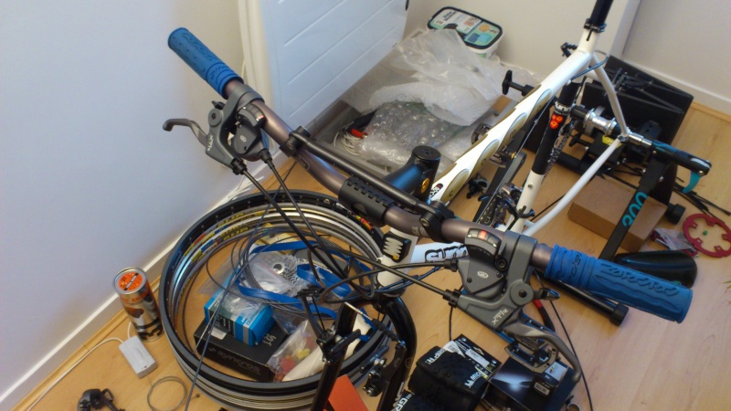

Hello,
some news of this project.
Here is a pic of the hubset and of the rims :
I chose black spokes to fit with the color of rims, fork and stickers of the frame :D
First wheel set with black spokes for me !
Hello,
Here is the final cassette ultegra 11/23, with xt 770 locking ring :
the weight is the same as dura ace 12/27
the other one is xt 770 to compare 11/32
