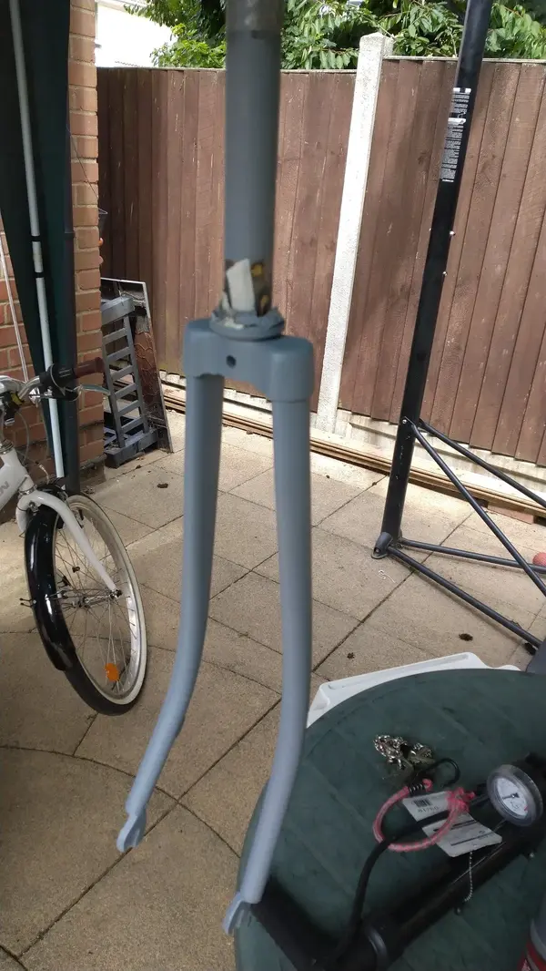

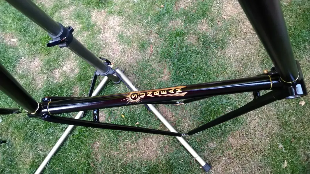

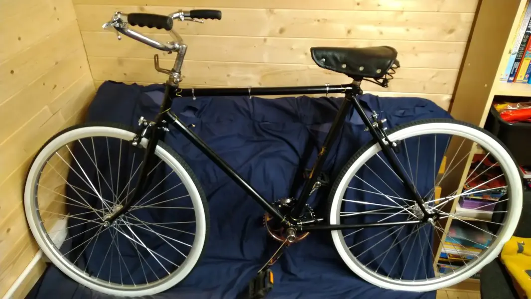

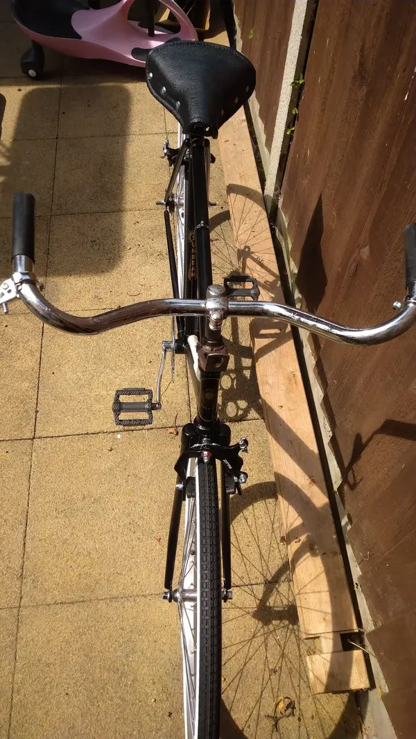

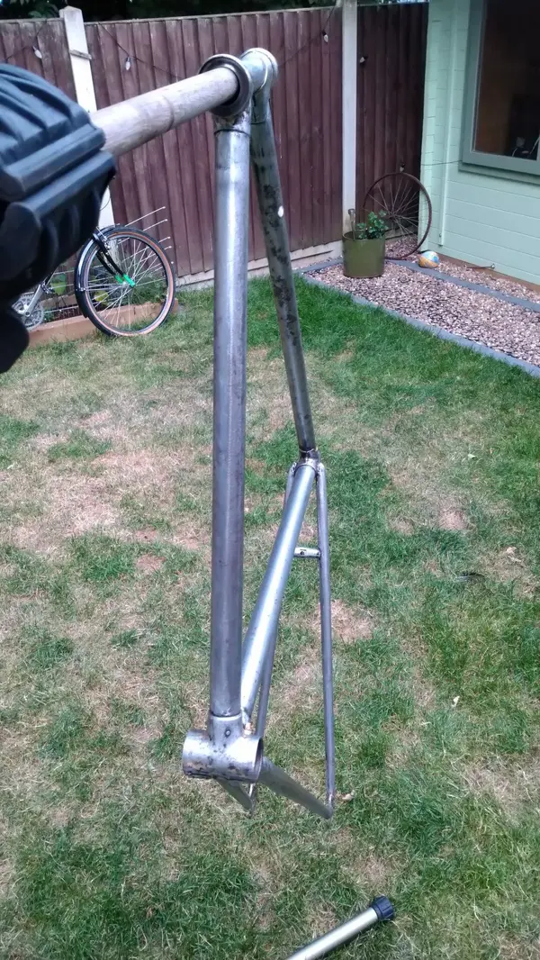

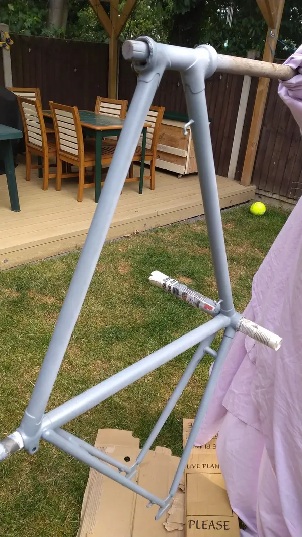

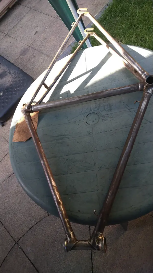

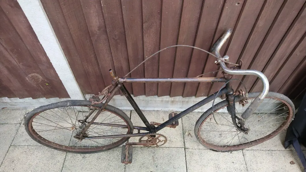

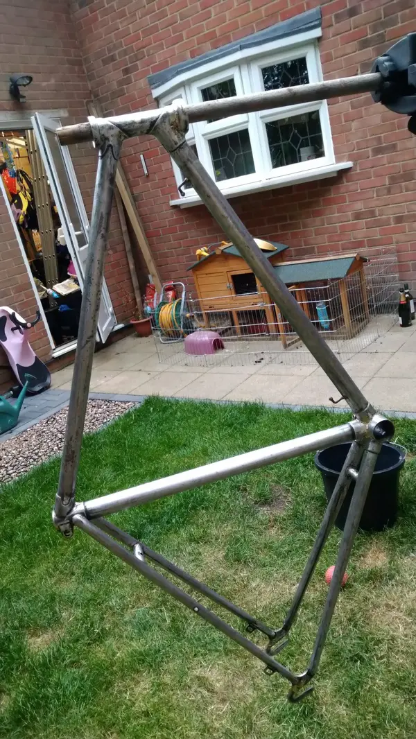

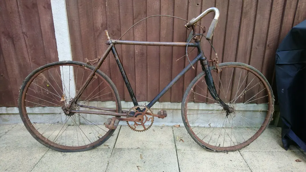

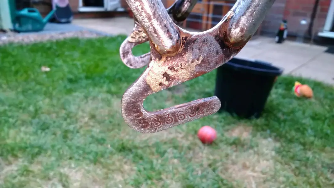

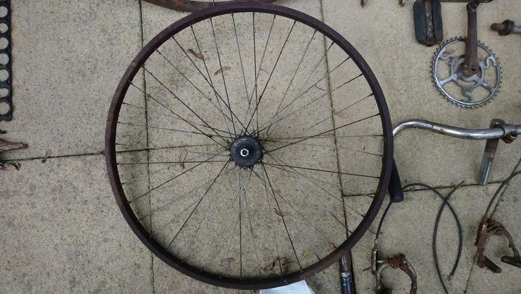

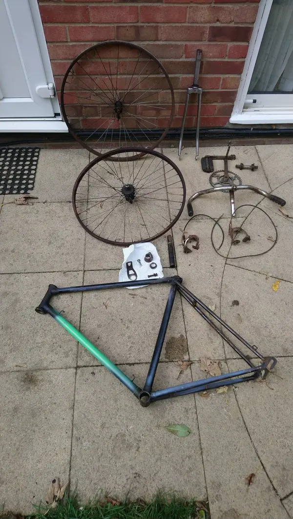

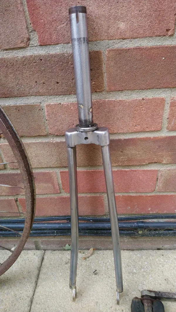

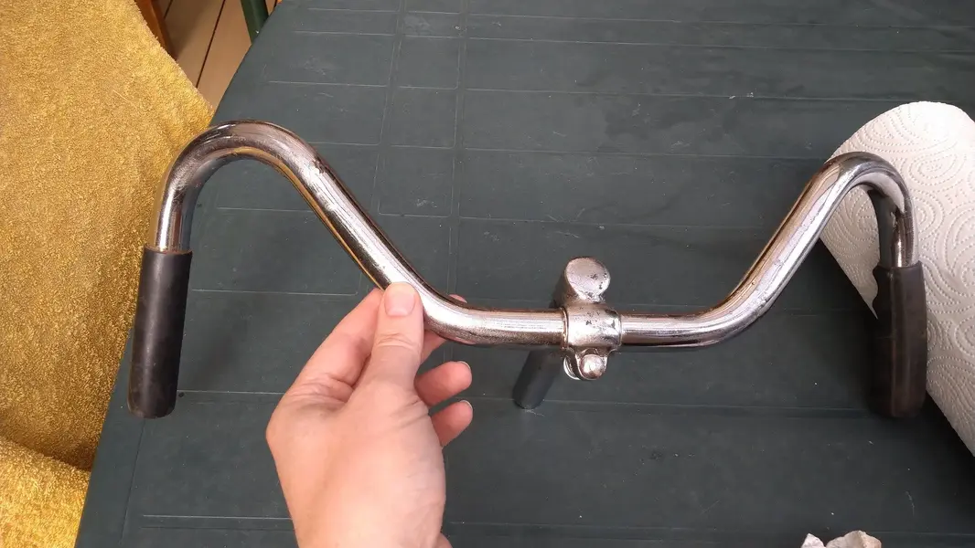

This is my father-in-law’s old bike that he bought when he was 13. I was given the bike by his son who had it for 20 years in his garden shed and he had planned to restore it to a working condition but recently concluded that he wasn’t going to do anything with it. I had reservations as it was in a bad way but if the post, stem and bb would come out, then it had potential. Interestingly enough it has a 110mm rear drop out, 90mm front drop out on the forks, and takes a 26 x 1 3/8 wheel. Frame and forks weigh in around 4kg. Plan is to strip off the paint and see what condition it is in and go from there. I will keep it single speed (flip/flop hub) but not sure whether to try out 700c or to stick with the 26 x 1 3/8 size wheels which I have found on eBay with the correct hub width for a reasonable price.

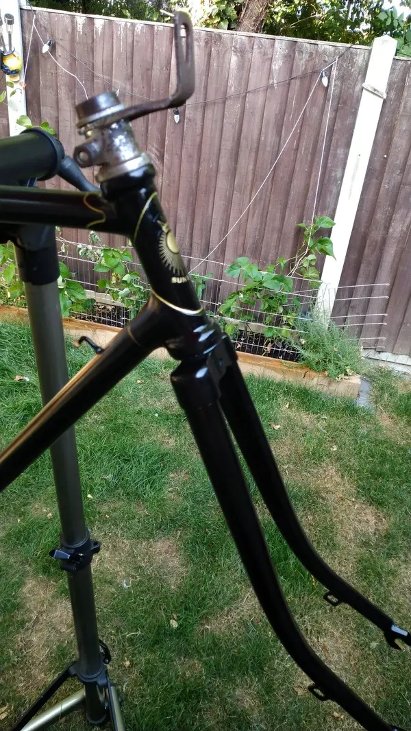

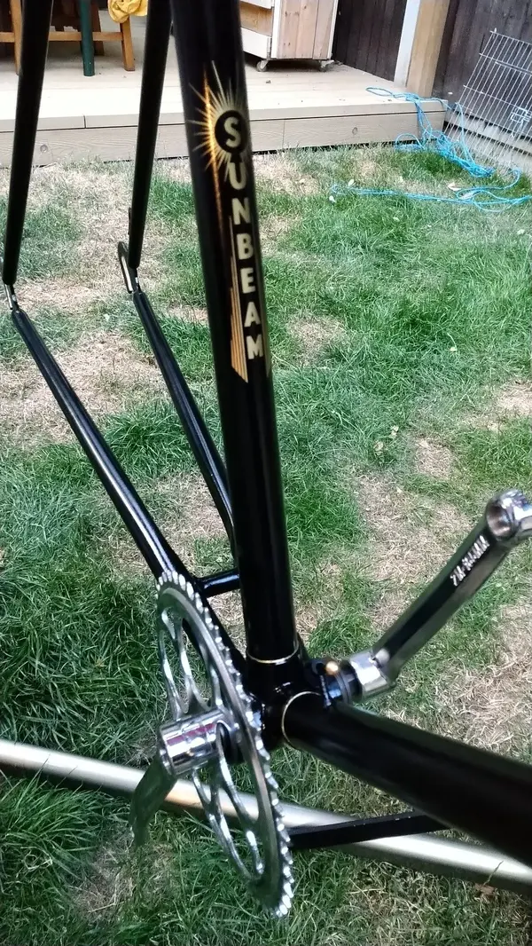

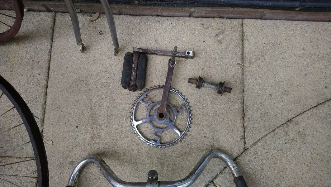

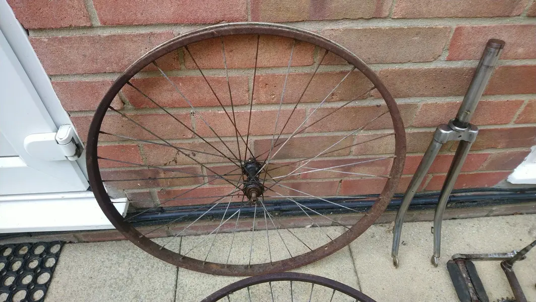

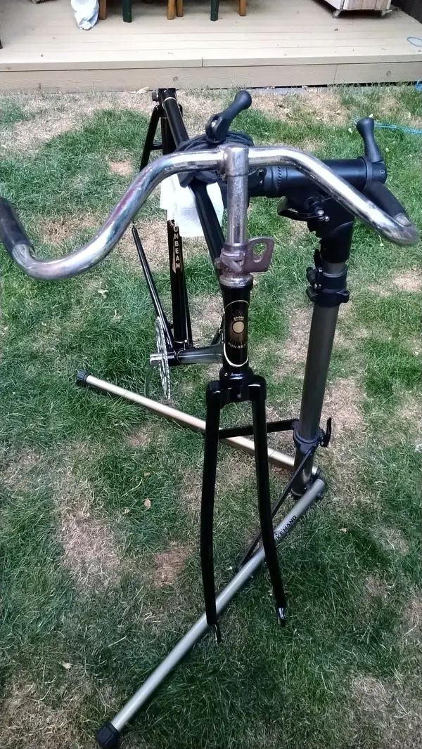

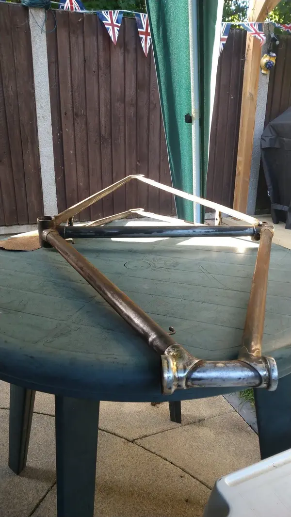

All the bits came off okay with help from penetrating oil. The pedals are stuck in the cranks and will need work but I will probably go for a cotterless crank and bb. So far the forks have come up well after sandpaper rub down. Next will be working on the frame.
