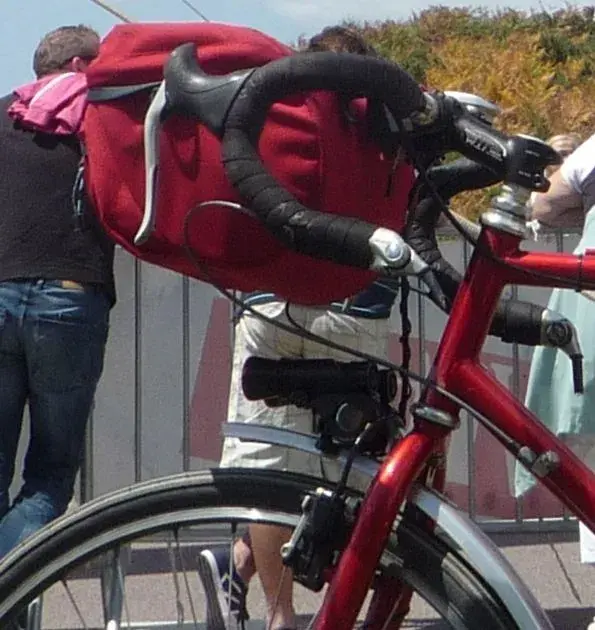

You could try this sort of thing that I built for my tourer - a 100mm length of 25mm aluminium tube secured to an SKS lamp bracket through the fork crown. Two lights with handlebar clamps then secure to the tube.
I really like your setup, what a great idea. However this is for my road bike so the front caliper is bolted through the forks and I'd be loathe to add anything else to it.
