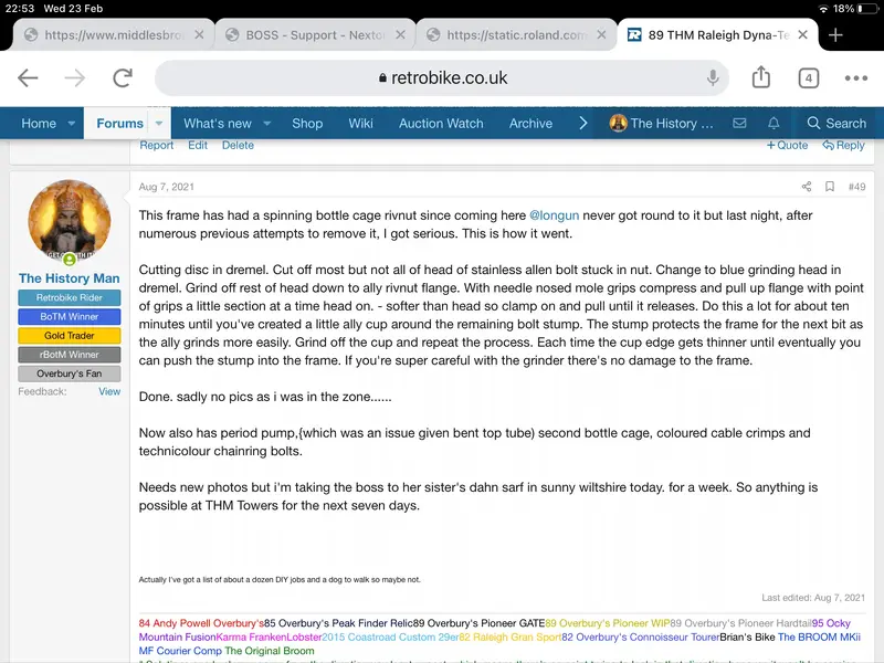

I’ve done this recently. If you want to save the cable guide it will take a little longer.
Grind or cut off bolt head to remove guide.
Then once guide remove grind bolt down to rivnut flange but no further. Use long nosed pliers or long nosed mole grips to grab soft rivnut flange crushing it into a cup around the bolt stump. Grind off cup and repeat cup making process. Eventually the bolt drops into the frame.
My Dynatech is testament to my success using this method without damaging frame. I I used needle nosed mole grips and a Dremel. 6F20013B-861D-481C-B0A2-96E89E379FA1.webp
