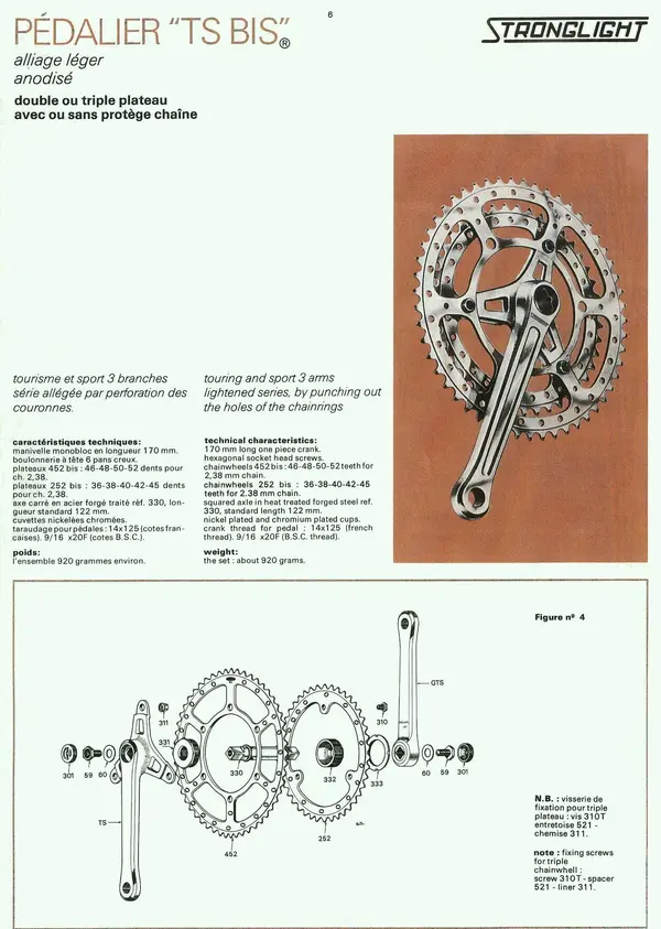

Stuggling at the moment, and I've had a Stronglight TS chainset on the short list which may save the day.
Would appreciate some help from someone who knows these very well.
Understood that these are a very early square taper crank, and that's what I'm after. Can't find much info. on the bottom bracket spindle though.
- were these designed for 5 / 6 speed rear spacing? Any issue with a 120mm OLN?
- what was the recommended BB choice from Stronglight back in the day?
- what length spindle and what sort of a chain line does it give?
- what is the distance between the bearing butts on the spindle?
- what is the taper? Is it JIS or ISO or a great mystery....?
Cheers for any help!

Got three JIS cup and cone style BBs in French thread, all Japanese Tange or Sugino in great condition which I thought I would use. Attempted to get the old fixed cup out using a bench vice, no go it slipped and I didn't want to insist and bugger everything up. Then attempted with a massive Facom adjustable wrench which didn't slip but I couldn't budge it. Not sure I want to get the blow-torch in there too :(
Then thought about keeping the old cups and replacing just the spindle - again no go because of the different bearing shoulders on the JIS spindles. Then tried another French cottered spindle and it all fitted perfect. It got me thinking that if I get an early French made square taper spindle it may just work out. Hench my detailed questions in the OP.
I see in the first exploded diagram above, part 330 seems to be in the BB number 34. I'm guessing that Stronglight may have thought about such retro-fits and this could get me out of a tricky situation. BB number 34 seems very very close to the old Torevess I have too so it's worth a chance.
Getting Stronglight TS cranks is easy enough around here, but they are all with French pedal threads of course :rolleyes:. To get TS cranks in 9/16" means shopping abroad - so far found sets in Italy, Spain and Lithuania.

What pedals came with EDN? Would it be easier to get French thread pedals for you rather than worry about 9/16"? Only way I've found with thin fixed cups is a length of 12mm ish studding and some thick washers to hold the spanner on. Also easier with the bike on its wheels. I assume you soaked it in plus gas? Old bikes are a pita no matter where they come from.
