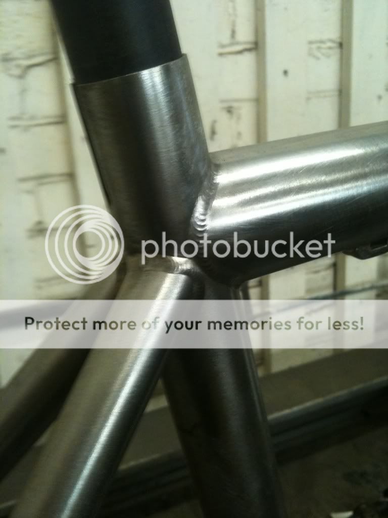

Its a 26' wheel hardtail. Its a large size as its going to Gil_M.
Basic details....
Reynolds 853 main triangle, True Temper rear end. S bend stays, breezer dropouts, 2.5 tyre clearance, built to run 69.5 head and 71 degree angles with a 140mm fork running 20% sag.
Frame has been constructed with TIG but will have all joints finished with nice smooth 'Faux Fillets' and the headtube area will have a Bilaminate treatment.
Bi-lam is an old english method that came about after the war when there was a real shortage of lugs. It involves cutting shapes out of flat steel, rolling it around the tube, before brazing into place to get the lugged look. Its largely decorative but also strengthens the headtube top, bottom and at the rear. Once they are on, and the rear portions are radiused into the top and down tubes with fillets it gives the impression that the headtube floats in a unitary front triangle. The added strength also negates the need for ugly gussets that production builders need to get through the CEN tests.
Here you can see the top and bottom parts of the bi-lam or 'faux' lug taking shape. A little more tweeking and filing and they can be brazed into place. The back bone isnt in the pic, I'm still making it, but will join the two pictured parts by wrapping around the back of the headtube between the tubes and out to run down the side of the head tube.
Heres the BB area. Now its TIG'd up it can be cleaned ready for the faux fillets. I've added a few small gussets to this area as the chainstays are bridgeless and it needs beefing up a little. I don't want any breakages!
A few random shots of the welding. Some folk add faux fillets to hide crappy welds. I just want to show you that these welds are pretty neat. Almost a shame to cover them up actually.
Seat mast is unfinished. I'm going to carve it into a micer shape before adding the braze on bold binder.
Thats your lot for now. I'm hoping to get the brazing done at the weekend and then get it all filed and sanded prior to paint. I will pop some more pics up when the fillets are done.
