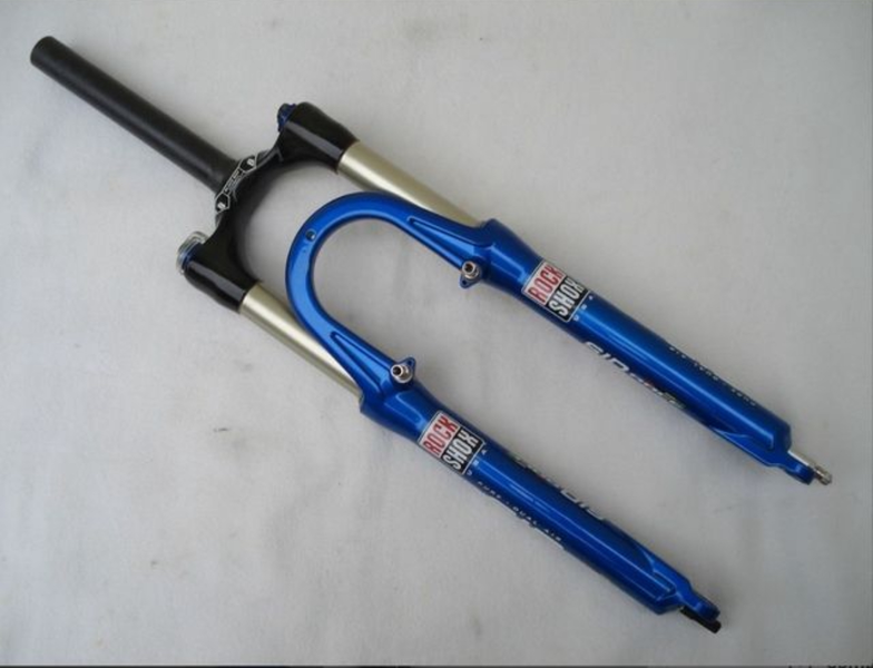

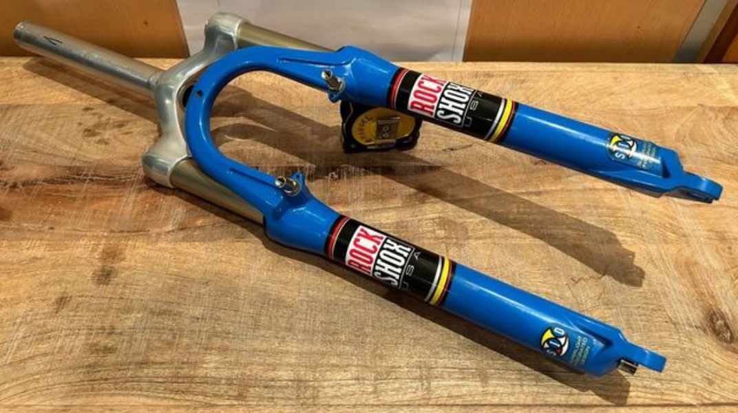

-Fork: A yellow Judy SL? There are already too many GTs with that configuration. Blue SID?... good option, there are several beautiful versions.
But I fancy another option, there is life beyond Manitou and Rock Shox. I have it clear

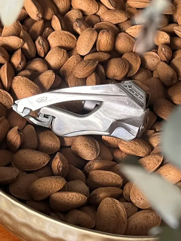

-Front derailleur: there was no Shimano option in those years, so it's clear, an XTR. I thought about a Top Swing because the low clamp allows you to see the frame better, it is cleaner. A 952 seemed like the best option to me, its gray color is not as dark as other XTRs and the spoon is shiny silver. They work great although it is easy for them to become loose if they are not taken care of.

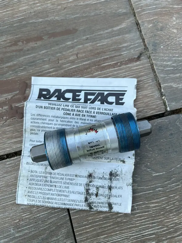

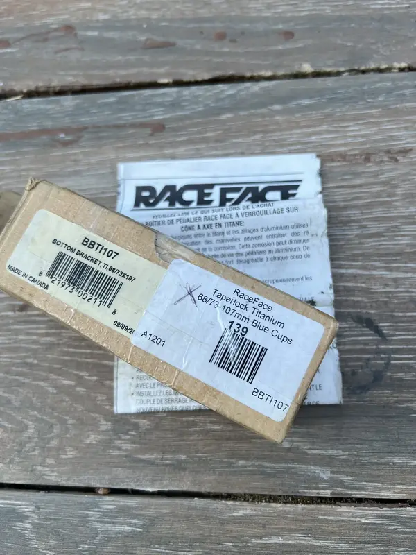

-Bottom bracket: Race Face Taperlock Ti in 107 mm. You can see the catalog of the cranks I wanted and put that used the Shimano 107 standard. I would have liked to check it before bringing the bottom bracket, but the cranks take a long time and if I wait for them and then order the bottom bracket, I end up in August, I go on vacation and I don't finish it until October. I prefer to take risks and trust the technical specifications.

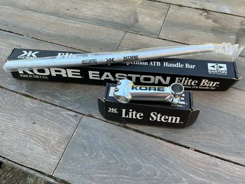

-Bar & Stem: Kore. In the '96 catalog it is what the Zaskar has, but that is not the reason, I don't want a catalog bike. It is simply because they deserve it. It is my tribute to a brand that was cool in the late '90s. Good pieces with good finishes, countless colors, reliable and more or less light. I had a red Kore with a Manitou SX Ti in the '90s and everyone stared.
In addition, its oval tubes looked very good with the new frame tubes that were no longer round as always. Everything fit well. We were talking about it in Spain the other day, now almost no one uses it, they don't give value to the brand. This is my little tribute to Kore.

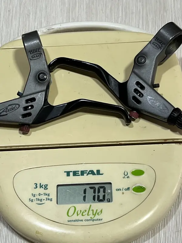

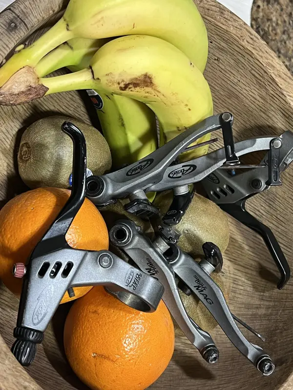

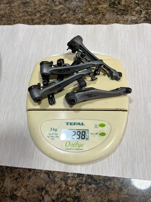

-The brakes: I got some Avid Mag...they are really nice and light. I also know that they work well. But... they look too similar to any other Avid I have some Single Digit 7s and they look too similar. I don't think I'll put them on even though I really like Avid. In any case, I can always use an Avid Mag in any project, they are a reliable bet.

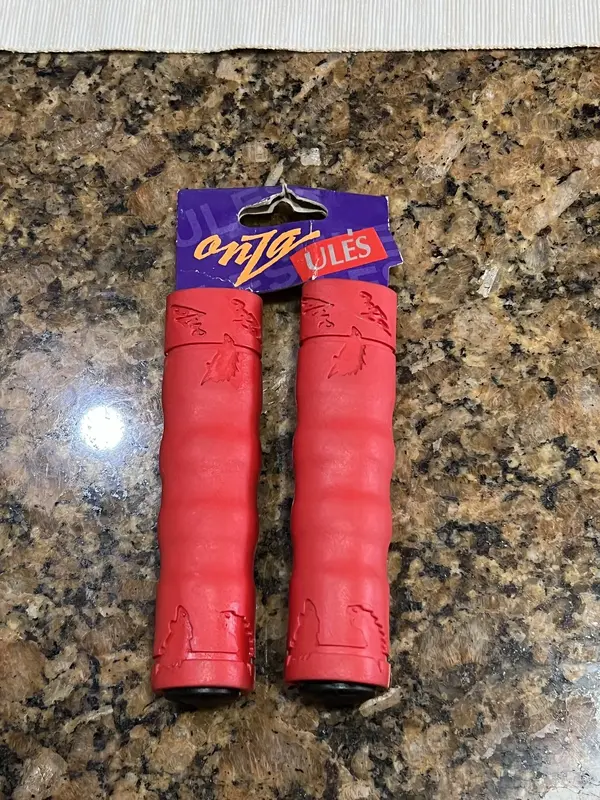

-Handlebar grips: Well, some red Onza Ule's. Yes, red. It doesn't seem like it but it makes sense, although I doubt it more and more. In any case I have plan "B", some Bontrager foam or some Ritchey which are always a solution that looks good. I'm still thinking.

For the forks, consider 2 options: a '98 SID. I think this was the best option, it has a beautiful blue and discreet yellow bands. The other a SID WCS Team in its dark candy blue version. It's amazingly pretty, with the Woodman headset in the same tone I have, a saddle lock or seat post in that color and some Woodman wheel locks in deep blue, I think it would also look pretty. But in the end I thought of another theme for the bike.

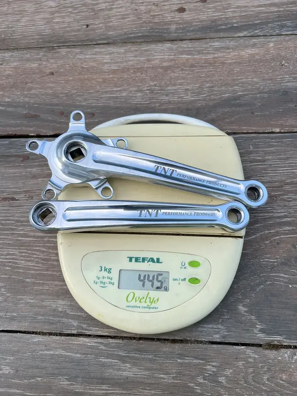

The cranks finally arrived.
It took me a while to find them but they appeared. Let's see if I can get the seatpost too.
